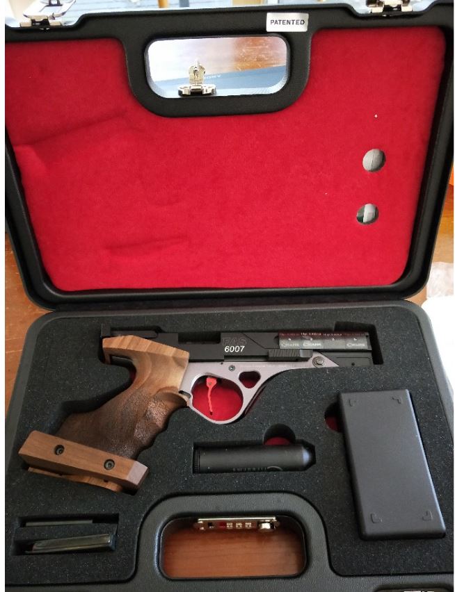

FAS 6007 - finally in my hands...
Post by Leon »
A couple of initial impressions -
Very high quality (including the packaging) - it seems that Chiappa has lifted the bar on these.
Lighter than a 607, which is a good thing.

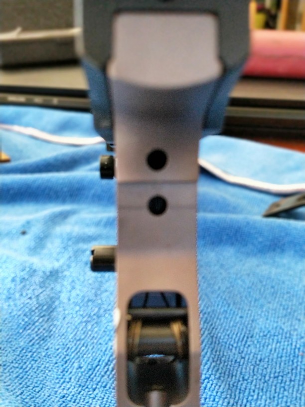

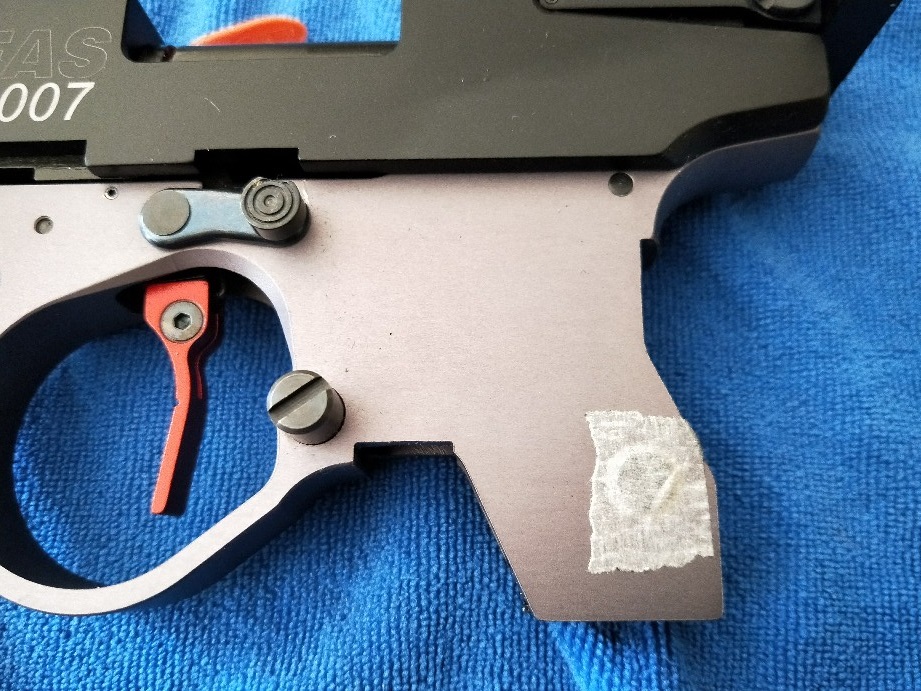

Some more impressions -
The 6007 is lighter than my 607 ( 980gr vs 1095gr), but you do have the option of adding more weights to the shroud.

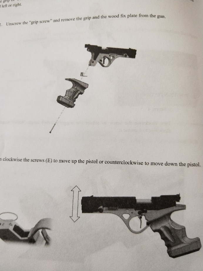

When I did fire it the other day, I thought that the bore line was lower than my 607. Well, it turns out that I was right. You can move the pistol up & down in the grip and can also adjust the rake fore & aft, and also to the left & right.
Excerpt from the manual below.

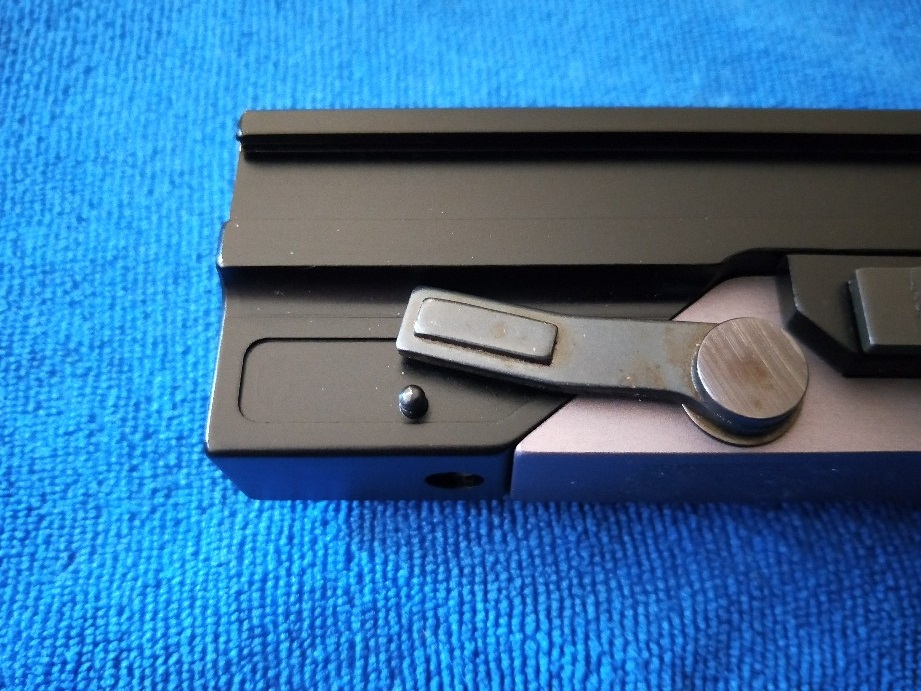

The take-down now has a spring-loaded pin to stop it from working itself loose...
The frame, slide and shroud have been CNC machined and are all made to a very high standard.

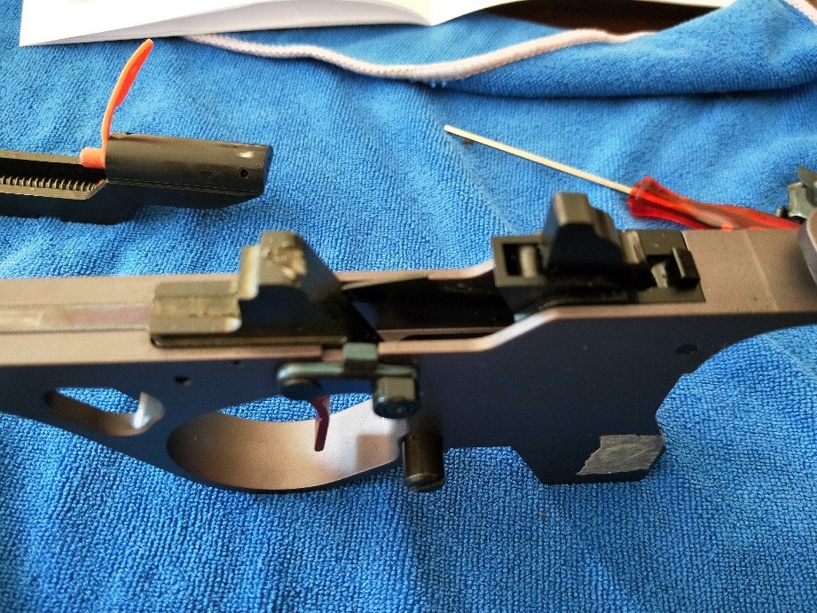

The trigger box is removeable - as per the image below...
