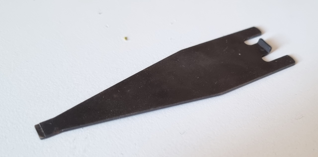

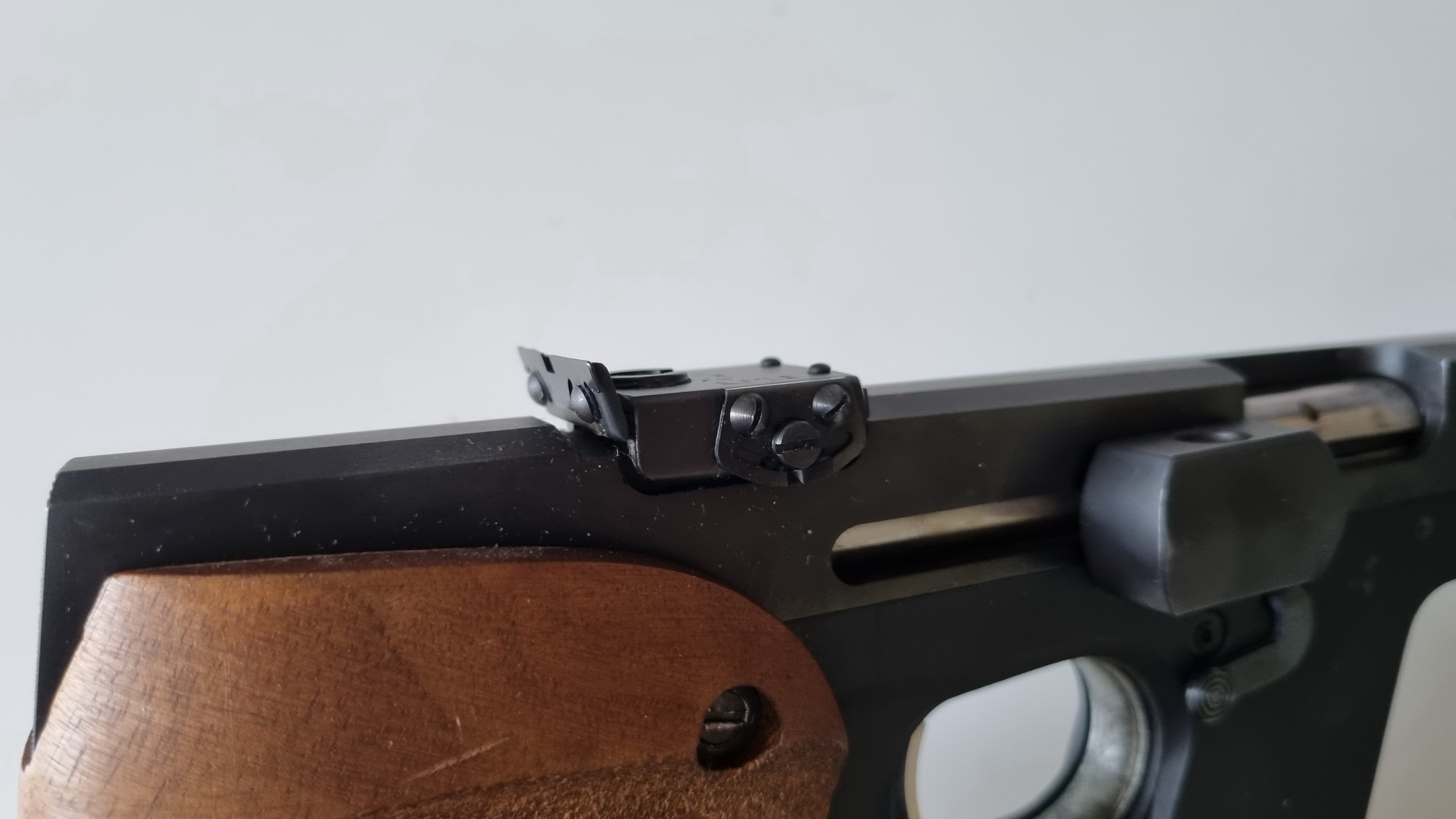

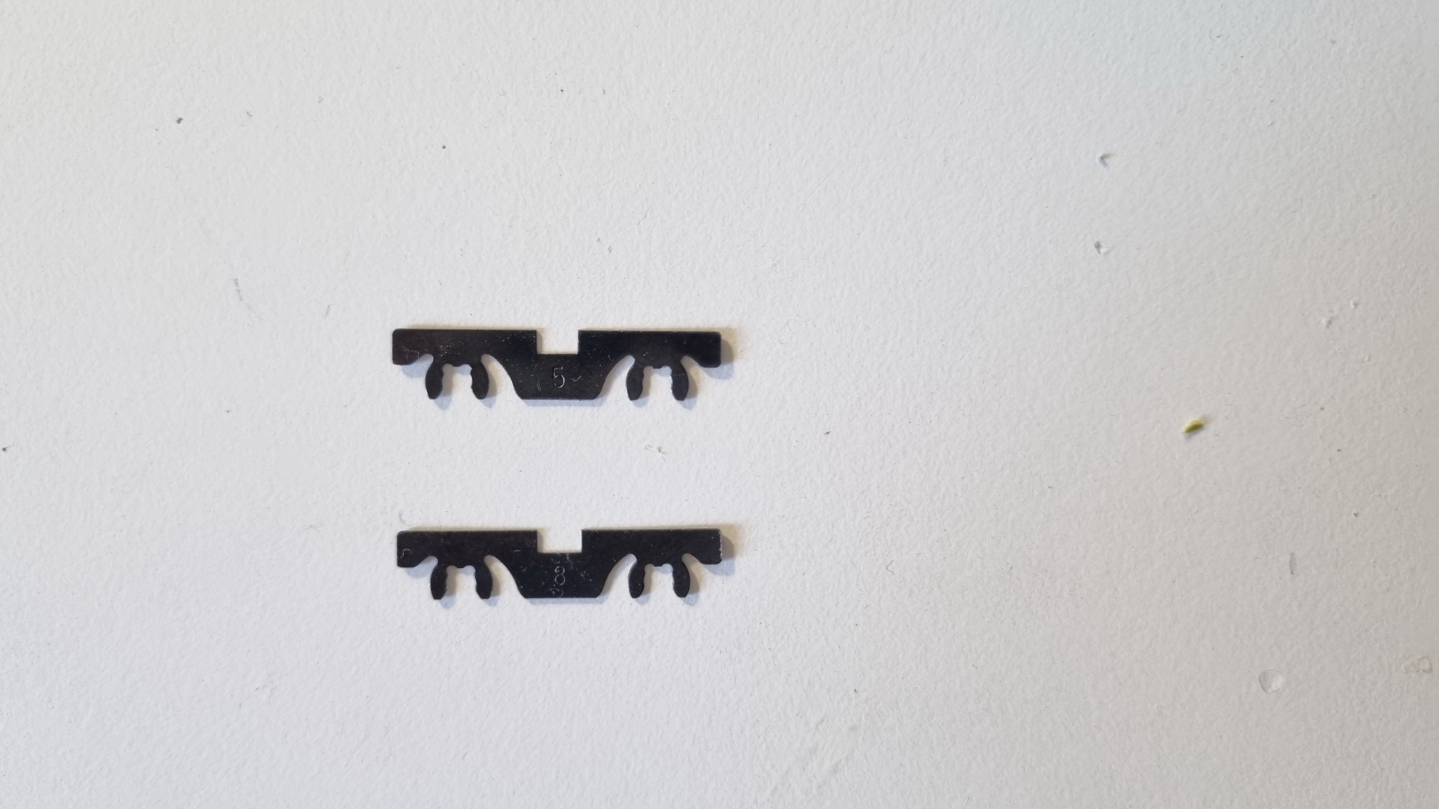

Posts: 451
Re: Help assembling/mounting Walther GSP rear sight
hi
i recently acquired a very old Walther GSP (from 1976). it came with some spare rear sight blades.. and i;d like to change it.
however, the mounting system is different from the one presented here.
anyone know how to remove the currently installed sight blade? (i have not found a manual version so old that it matches my pistol)

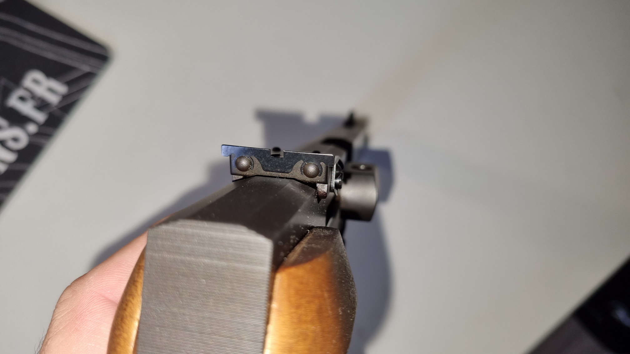

Posts: 451
David Levene wrote: Mon Aug 16, 2021 6:00 am The old site blades slid off to the side.
I'm not sure whether the newer blades will fit on the old pins.
these ones are even older. they seem to go in from above. the installed one and the replacement use the same system.
however, getting the currently installed one off by pulling up at the corners, does not seem to work

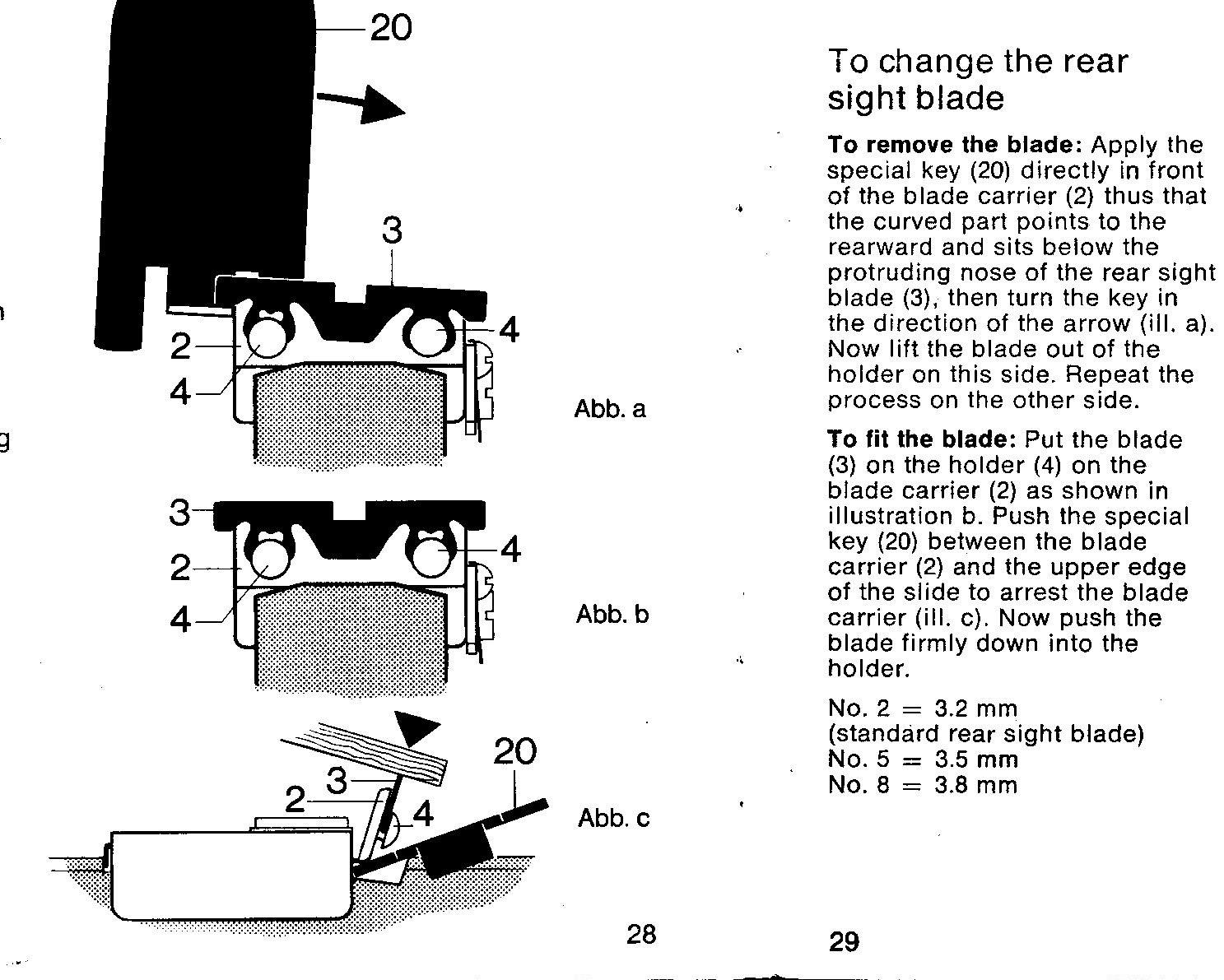

fc60
Posts: 758
Post by fc60 »
Greetings,
Yes, that is the "Special Key".
Support the main housing as much as possible to prevent twisting it.
Here is an image from Manual 1273.20.3 217 21 51...

fc60
Posts: 758
Post by fc60 »
Greetings,
Yes, I have the whole manual as quoted in my post.
There are several sources for on-line downloads of newer manuals.
