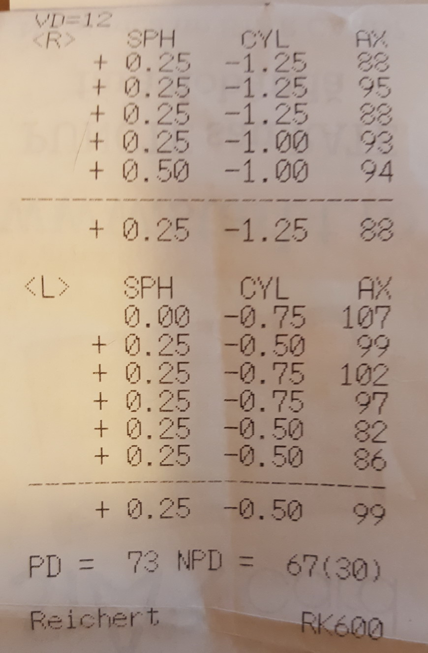

Posts: 399
Re: Eyewear confusion
hi
i read some of the threads on optics, but i am still confused. maybe because i don;t know much about glasses or maybe here we have different terminology:
for my understanding, there are 2 types of lenses: for close distance (reading) and far distance (normal wear)
for reading glasses, the diopters are marked with + sign and the distance glasses, the diopters are marked with - sign
i've read that for shooting clarity one would need a +0.75 diopter added to the distance prescription.
i have a -0.50 prescription (distance glasses) and nothing for close (no reading glasses).
so my question is, how should my prescription be changed for shooting?
* +0.25 (mathematical adding)
* -1.25 (adding 0.75 to my 0.50 distance prescription)
* +0.75 (ignore distance prescription, use reading diopter only)
* other value?
STP: Walther GSP 22
CFP: Walther GSP 32
For pistol shooting the starting point would be a lens strength of +.25. Do you know whether your have any correction for astigmatism?
Posts: 399
no idea... this is the result of the eye exam...
so a +0.25 : that's almost like the naked eye. the thing is, with the -0.50 diopter, the front sight is more clear than with the naked eye, so the glasses do work...
From my reading of that prescription you have a distance prescription of +0.25. If you add +0.75 you will get +1.00.
Assuming that you are right eyed you need a -1.25 astigmatism correction at 88 degrees.
But hey, I'm not an optician.
Posts: 3292
The "cylinder" numbers indicate that you have significant astigmatism. A plain +0.25D lens is going to produce some distortion. You need to add +0.75D to the "SPH" numbers, and get a lens ground to include the astigmatism correction. At least I think that is right...

Posts: 399
the doctor prescribed a -0.25 (left) and -0.50(right) glasses. the sight improved for both eyes, but i still aim with my left eye (i am right handed) because the right eye image is still too blurry (the glasses were done for work/computer, not shooting)
guess i have to go back to the doctor for another prescription for shooting glasses. but i;m afraid she will not know anything about shooting - i don;t think there is a person that knows anything about 10m pistol shooting in a 200 km radius, optics or anything else :) - so i'd like to know as much as possible myself before, so i can get a good prescription

Posts: 7001
It's simple: First, get your astigmatism corrected, then have your eye(s) focus on the front sight, whatever correction that is. Bring your AP with you for fitting. Cover the back of the lens of your non-shooting eye with matte cellophane tape.

-TT-
Posts: 406
Post by -TT- »
You don't really need to bring in the gun, the important thing is the distance from your shooting eye to the spot you want it to focus on, when you're in your normal stance. It's farther than reading or computer use, but she'll figure it out if you pose with a pencil or something in your hand. Ok, maybe bring a tape measure. :-)
Posts: 3292
Having a prescription that pulls your distance (relaxed) focus all the way in to the front sight may make the target blurrier than you would like. The diopter strength is 1/f, where "f" is the focal length in meters. The recommended starting point of 0.75D has a focal length of 1.33 meters, which is well past your front sight. The team I help coach has many students that prefer only +0.5D (2 meter focal length) added correction because the target is less blurry that way. A lot will also depend on the typical range lighting where you shoot. Bright lighting will help to increase your depth of field, and make the target less blurry.
Another approach is to experiment at the range with something like this:
https://shootingsight.com/product/test-lens-frame/
along with your regular glasses to see how much correction you like.
Depending on what sort of glasses frame you are using, you may want to start out with +0.5D added to your prescription, and then try clip-on lenses to test additional correction. I've done that with my Champion Brillen frames.
