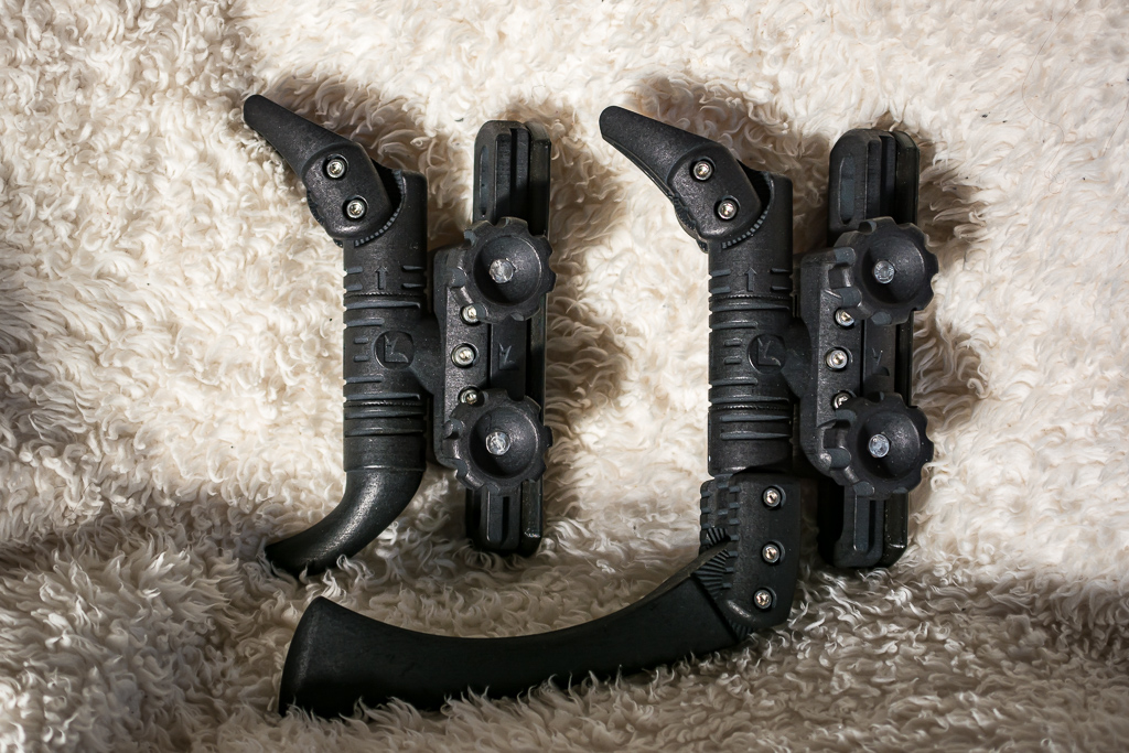

Hi guys,
I'm just wondering if these butt plates are ISSF compatible for air rifles (the small one) and for smallbore rifles (the one with the hook).
Originally, I designed them for Field Target and Hunter Field Target and there are some much wilder configurations that I don't even show to you :-), but maybe these two are within the ISSF rules
I suppose the thumb screws have to be replaced with hex cap bolts but apart from that, is there anything on them that should be modified, in order to make them suitable for ISSF shooters?
Thank you in advance for your ideas!

Without putting a ruler or caliper on them it is tough to know for sure.
As noted, for air rifle, the thumb screws might need to be a little more svelte but overall, my impression is these would be ISSF legal.
'Dude

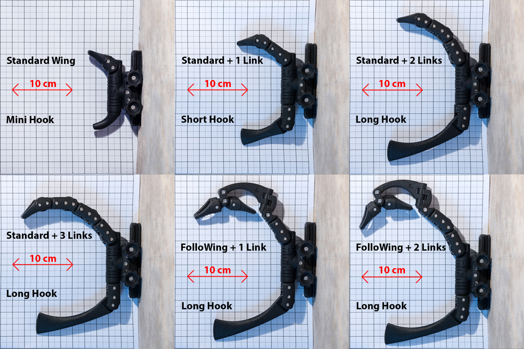

I've read through the ISSF rules and - for me at least - it seems that they are nicely within the limits. But I shoot another discipline and I suppose you know these rules much better, whether there is a trick in them. I attached a photo where you can see a paper with a 1cm raster behind the hooks, maybe this helps:

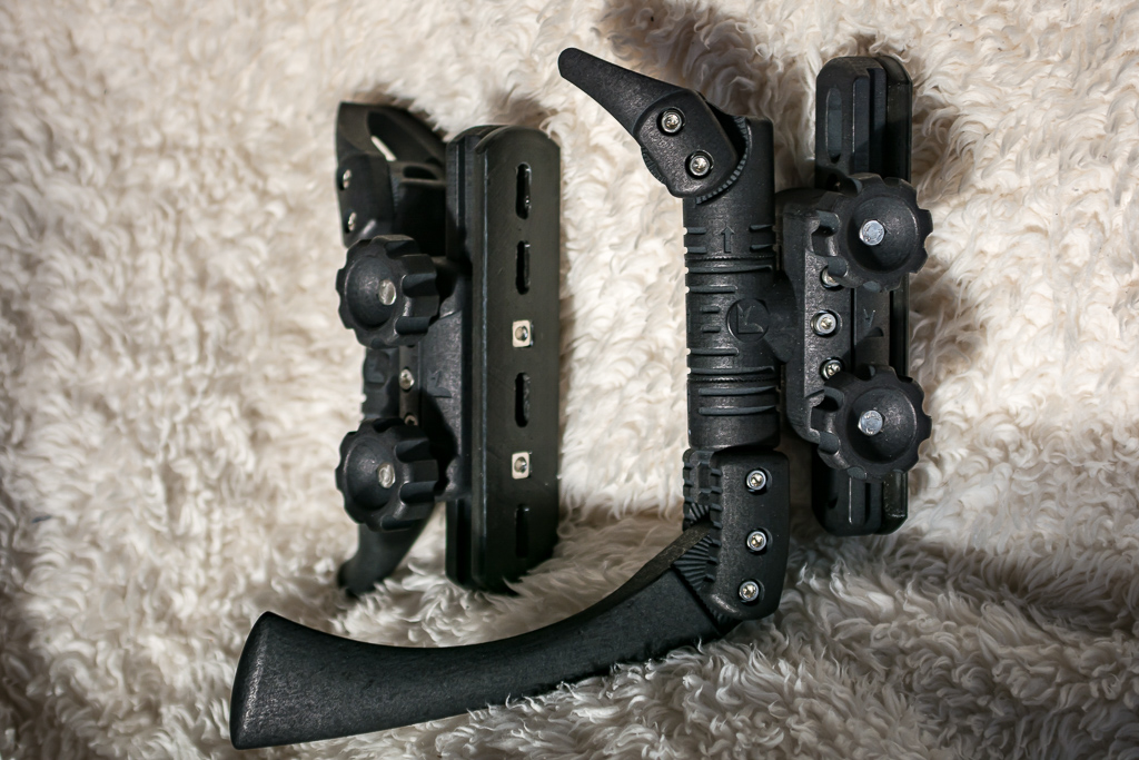

ProdigalSon wrote: Fri Dec 28, 2018 4:56 pmAs long as the bolt holes are in the right location, slapping one of these on a 1903 would be an easy and huge upgrade from the stock gear.
If you have a look at the last picture, you can see the vertical slots at the back of the base plate. They are designed in a way that any distance between 10 and 100mm (CTC) can be mounted with M4 to M6 size bolts. The two slots at the end allow mounting between 80-100mm, the next pair 60-80mm, then 45-65, 25-45, 10-30.
The square plate on the photos is rather for the metal stocks, but if you can draw around the wooden stock's end then I can design a bespoke base plate that fits to the stock and has the holes in the right place.

For Air Rifle only the first one would be legal. Air Rifles do not allow a hook and maximum depth of 20mm.
For 50m rifles, without picking the rules apart line by line only the top three are legal. The top links cannot project more than 25mm past the deepest part of the plate. Additionally the lower hook cannot extend more than 153mm past the deepest part of the plate with any outside curve measuring not more than 178mm. See 7.4.5.1
Now, those are the rules for straight up ISSF compliance. Looking at these full up, depending on the butt carrier, there may not be enough vertical adjustment on these for them to be useful in 3 position competition, especially for a taller shooter.
As this conversation develops I see you are in the UK and would naturally use metric fasteners. There is a problem in the USA with folks running little machine and production shops using 'standard' US fasteners. (Everything in inches and fractions) The net result is some interesting stuff that is fundamentally crap because it is difficult to use in competition.
'Dude

justadude wrote: Tue Jan 08, 2019 8:47 amFor Air Rifle only the first one would be legal.
Yes I know, I posted this last photo only to see the sizes, but it displays all 6 upper wing variations and all 3 hook types.
I know that only the 'Standard wing' will be ISSF compatible, with the Mini hook for air rifle and with the Short/Long hook for smallbore.
