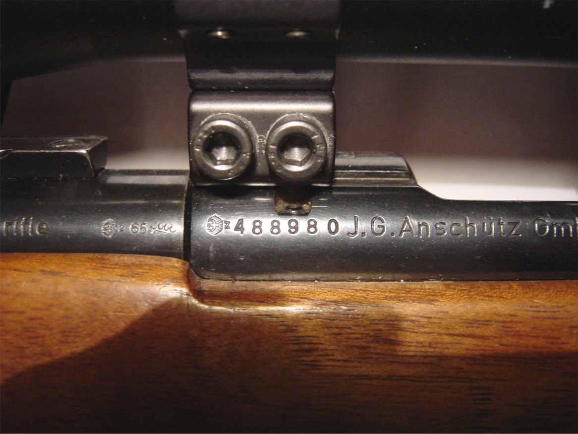

Hi, in my search for answers I have just come across your forum - perhaps someone has an answer.
let me introduce myself first - name is Gunter, live in the SE of England (Kent), have been shooting all my life (target and everything else)
- Life Member NRA (USA) 1974.
Getting old now (72) and can only usefully shoot from a rest with a scope now.
So I shoot .22 Benchrest 50m (really only semi-Benchrest, as one can only use a front-rest)
and doing not too bad with an old Anschutz Super Match I bought about 2 years ago!
Now here comes the point:
it's definitely a 14xx action with the wing safety
the (heavy match barrel is marked 65 for 1965 at the proof mark
But - the serial number of the action is 488xxx (NO 'X' after the s/n)
according to what I've found so far the s/n for 1965 should be somewhere in the region of
50-60.000?
Has someone in the past changed the barrel for a new old-stock barrel?
the s/n of the action seems to be very high for a 1410?

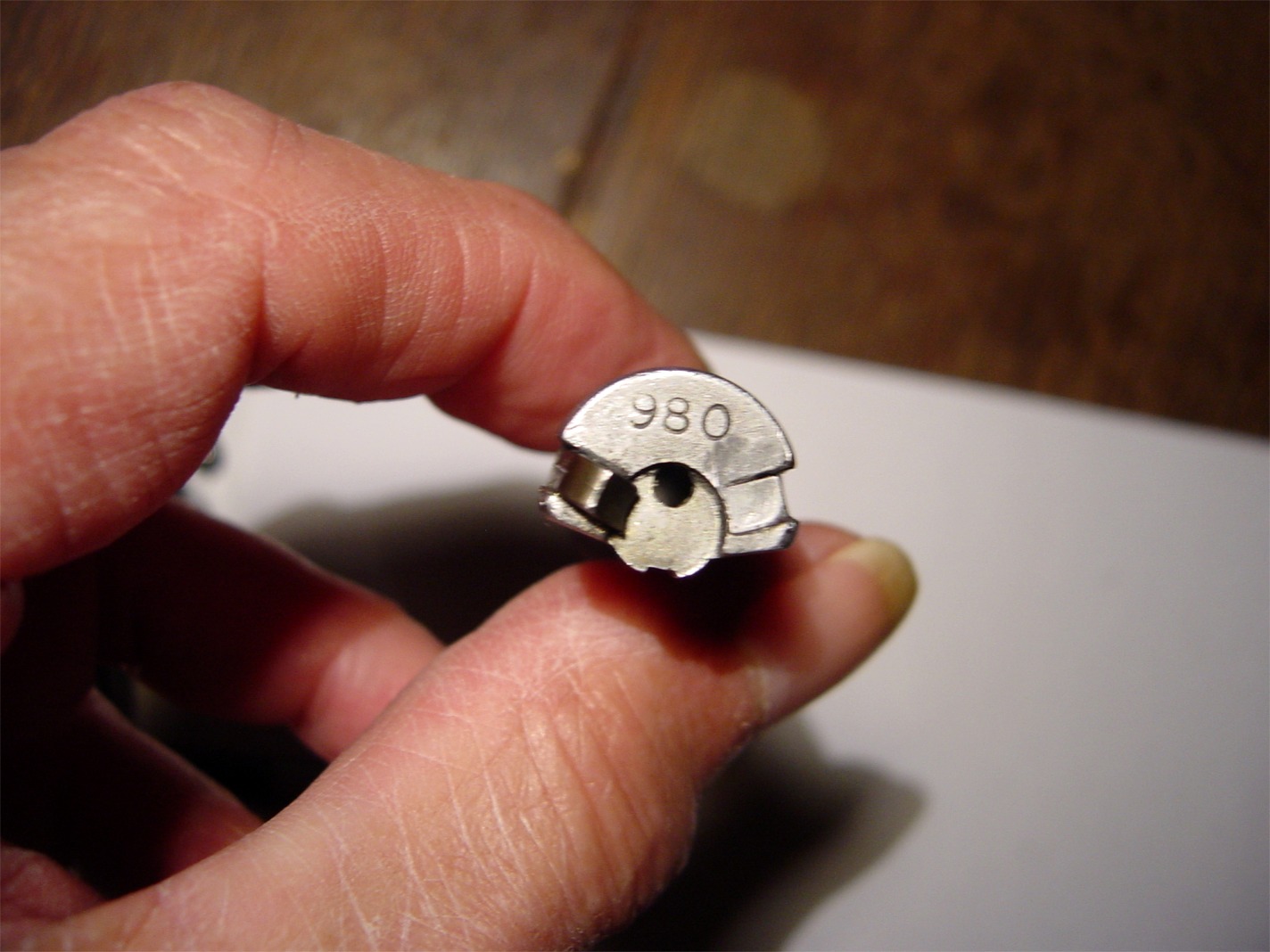

The bolt is correct and marked to the action with last 3 numbers
Headspace is correct.

Regarding the serial number, 48,8xx isn't very far from 50,000. It's possible the original barrel was replaced, with a very slightly newer one. Perhaps the original was faulty, or damaged soon after purchase, and went back to the factory. However, it may simply be the original, and the serial number just crept into 1965.
It's odd the bolt has two claws, but the barrel only one relief slot. But, remember that Anschutz fit the barrel first. They then fit a bolt, setting the headspace with the handle. It's not inconceivable that they ran out of single claw bolts before compatible barrels.
Fitting an 1800 FP and spring is more puzzling. I'm surprised you got the to work, as Anschutz changed the sear geometry for the 1800, moving the sear about 2mm forwards; normally it takes quite a bit of fettling to get a 1400 trigger to meet an 1800 FP enough to cock. I'd also doubt whether the bayonet-fit end cap also would properly compress the smaller rear spring, which provides quite a bit of the strike energy, as it was meant to be used with a screw-fit cap. The geometry of the cam in the bolt handle also changed.
Anschutz did change the 1400 FP around 1965, making the cocking indicator a separate piece. Did you mean this, or perhaps a 1600? These have the same sear geometry as a 1400.

the s/n is 488,xxx !

Hmmm, a high 400,000 range SN would be odd. Anschutz numbered Match 54 target rifles sequentially from the 1950s to the 2000s, when they added an extra digit. I think SNs were in the high 300,000s when they changed. Although the basic receiver dimensions didn't change, a 1913 receiver is visually distinct from a 1413. Since you mention a wing safety that gives us a manufacturing date of 1977 at the very latest. So the SN should be ca 150,000 tops (I forget exactly where the 1600s started, but it's thereabouts). Are you sure it's 4xx,xxx?

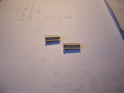

Two part firing pins were introduced in the 1960s, some time around 1966.The separate indicator pin was noticeably fatter than the "spike" integral to the older pins. 1600 and 18/1900 indicator pins are longer and slimmer, and have much stiffer springs; 18/1900 small springs are stiffer than 1600 springs, inverse to the strength of the main spring.
As for the firing pin itself, all 1800/1900 firing pins have a notch at the front of the bent, so it's unlikely to be a gunsmith modification to fit a 5039 trigger. The 5018 trigger fitted to 1800 and 1900 Match 54s has a sear that matches the notch. 1400 and 1600 FPs have a square edge, and 14/1600 trigger sears are shaped accordingly. Normally an 1800 pin won't reach a 1400 sear to cock. You'd have to perform some jiggery-pokery to slide a 1400 trigger further back so it engages the 1800 pin. I'd wonder why anyone went to that much trouble though, as 1400 pins were readily available until only a few years ago.

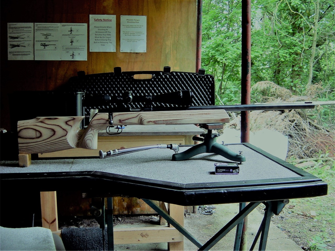

have taken some pics in the dark - would have been better in daylight, but will suffice, I trust...
Also, my Springer Spaniel decided to get in the way when she saw me getting a gun out of the safe!
If you know Springers, you know what I mean! They can seriously get in the way - very excitable - hehe.
Anyway, no, I don't think I'm going to get the action out of the wood for a few pics - have only recently re-bedded the thing and finally managed to get the torques right and the thing shoots in the 10mm ten-ring on 50m!

definitely a 1400 round action

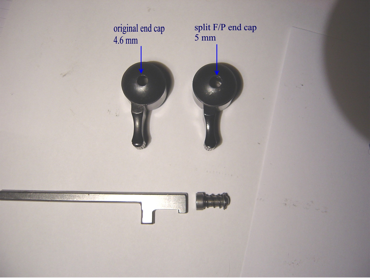

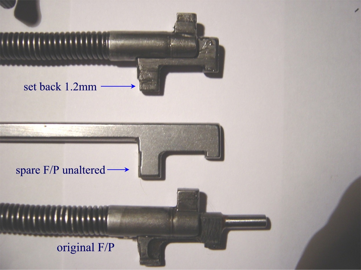

original F/P onepiece - see pic
new F/P 2 parts, fatter endpiece, as you say - pic shows diff. end caps with hole 4.6mm and 5mm
so, it's not an 1800 F/P, as I assumed - have learned something!
Nevertheless, the new F/P has definitely been ground back - just measured it - approx 1 - 1.2mm set back as shown in pic - looks done professionally? certainly the angle is 90 deg (square).

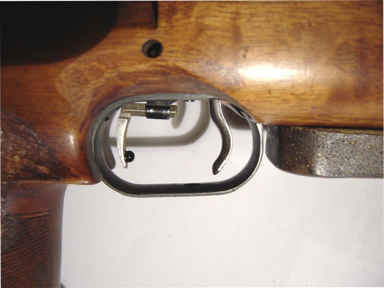

Re: Anschutz 54 Super Match conundrum
here some pics, if it works:
it has certainly given me something interesting to do on an otherwise boring saturday evening!
If I can learn something from this exercise, so much the better - and I have learned something already!
Best regards
Gunter
Best regards
Gunter
missed a pic - didn't show
here goes:
here goes:
Gunter,
That's definitely a 6-digit serial number. I suspect the final 0 is a mistake, and it should be 48,898. Although the 0 is repeated on the bolt, I'm not surprised since these are fitted after the barrel. It's also possible the bolt is not the original, but a later replacement; that would explain the two-claw bolt. I think this is a 1960s rifle, with a unique serial number, not a 1913 receiver with 1960s parts. It's easy to check though. 1913 receivers have a notch on the underside, just ahead of the forward bedding bolt hole. A 1960s 1400 receiver won't have this. The few replacement parts are unremarkable on a 53yo rifle; these are exactly what the factory service team would supply at Bisley.
I see the firing pin now. That's a later model 1400 pin. An 18/1900 pin is much slimmer, and the notch is far more pronounced. I think the bent has been filed to engage better with the trigger. It''s also possible there was a burr to remove, or that the filer wanted to increase strike depth on the case.
I'm not sure that hard bolt closure always means tight headspace. My first rifle, a 1970 1407, was always stiff, but the Anschutz team at Bisley declared the headspace was too wide. I know of rifles with correct (0.042-43in) headspace that close easily with just a finger.

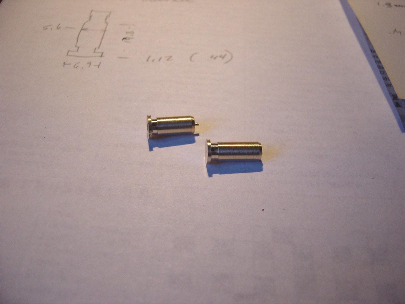

have just remembered that I have a lathe! - and decided to save myself some money
made a couple of gauges from hard brass - had a convenient 8mm rod lying around.
one is 1.10mm (43.5) - bolt just shuts on it with pressure
the other 1.05mm (41.5?) - no resistance at all
so, 43.5 or 43 it is!
my earlier 'scientific' experimental measurement with thin cigarette paper card came
pretty darn close! hehe
I suppose I don't have to worry about tightening this up?
As I said, this rifle shoots pretty good provided I don't wobble and keep concentrated
Best regards
Gunter
Hi all,
it's been some time - still shooting the old girl and having acceptable results for my age. (a few more Kent County Medals)
Tim - thanks for the tip on HS shims! Have bought a selection and run with a .2mm shim
Have changed over to SK Flatnose Match for practice and Lapua Center X for comp.
Good stuff! - and no more 'gunking up' of the chamber and 'misfires' as had become regular with Eley Sport & Match.
Have also spent some more money I don't really have (hehe) and bought one of the BR50 Stock clones from that chap in Yorkshire!
After adjusting the inletting, making & fitting a proper (steel) recoil lug and bedding the action (I've got a milling machine, which helps!),
I'm very pleased with it. £200+ well spent!
Also made some 'fine adjustment' to my Junior Caldwell rest.
vertical fine adj. - flexible 6mm hex extension for cordless drill (with hand-wheel attached)
drilled through foot and put m6 thread on a long 6mm hex bit
then, one day when I was bored and had come across some (worm)gear motors on ebay (from China of course)
I had a further look to see whether one could find a cross-slide for a mini lathe - and I found one - in China again! hehe
Took the hand crank off the slide and attached the motor - which conveniently had an m6 threaded rod attached (same as the
handcrank on the slide) and made a plate to match the two.
used an Eley ammo box to make the control (a car window switch, a battery holder for 2 CR123s and some connectors I had in
my Ham Radio spares box.
Attached the thing to the Caldwell with 4 screws to an intermediate wood-block (will change to Aluminium soon)
and took it to the range - works a treat!!
Especially if Kent is going to change to the 25m targets on 50m, as is currently talked about (10 bulls on a card; one shot on each)
So, enough for today, greetings to all and good shooting
Gunter
