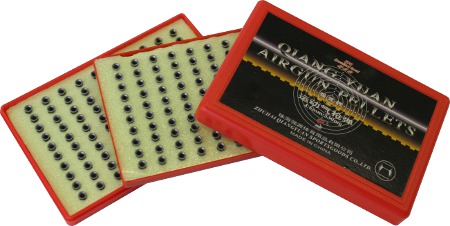

Ok. you asked for it.....
Qiang Yuan Qlympic pellets from China.
They are 4.49 mm diameter and 0.53 g per pellet . packed on seperate 200 pcs. sheets.
Minimum order is 10'000 pcs.
But you need to get the special ones made for there Olympic team only that are
4.493 mm diameter and have been sorted by Brinell hardness of 38–50 MPa,
and a maxamim oxidation state of −1.1 (an amphoteric oxide) with a Shear modulus 5.6 GPa.
So you will have to move to China and join there Olympic team as these are not for sale to the general public and cannot be imported into the United States.
- olympic-450.jpg (37 KiB) Viewed 5665 times

.....whoooosh !
