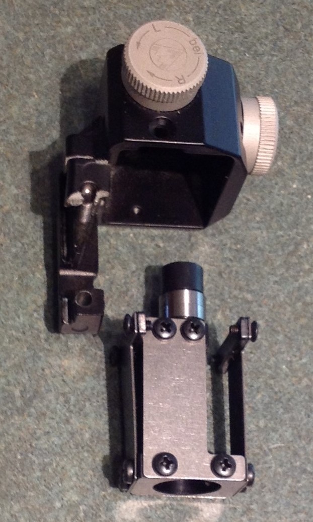

No not a sliding plate design. They are pretty unique. They use a sort-of parallelogram with little leaf springs. Below is one in pieces. This one has a broken mount as i described. The spring assembly is shown as it screws into the main housing. Back where the eyepiece mounts you can see two little ball bearings. These are where the adjustment screws bear against the assembly. Not much to go wrong unless you crack them or strip the adjustment screws.

Thanks for that. (a bit wierd!) Presumably though they rely on the springs holding the carrier against the two adjusters?

TenMetrePeter wrote:Presumably though they rely on the springs holding the carrier against the two adjusters?
Right- the springs keep the whole assembly pushed up against the adjustment screws. I think it is a very clever very low friction (just the ball bearings contribute a little friction I suppose) zero backlash design.
