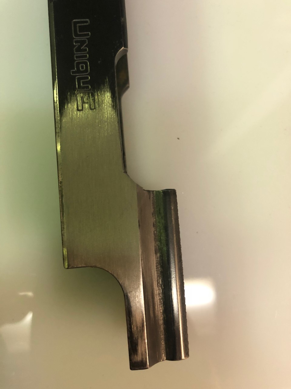

Cracked slide DES 32
Picture of the cracked DES 32 slide....

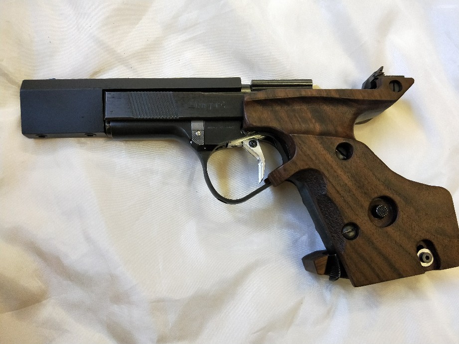

My DES 32
My DES 32
My DES 32

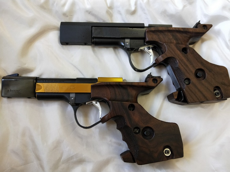

DES 32 and 96 together
DES 32 & 96
DES 32 & 96

The cracked slide is well worth a repair attempt.
Regarding your DES32U, I see you have the optional heavy weight. Mine is a much smaller device.

Léon, Dave, mine came with that huge square profile weight. With it installed the pistol is somewhere around 100 grams over the ISSF limit. Since I put a sight base and an Ultradot on it for NRA match use, I never did fire it with that monster on it. I did see a note from some user in Europe I think, who milled off a lot of the mass o get a profile like the 260 gram version. Mine just sulks in a drawer in the shop.

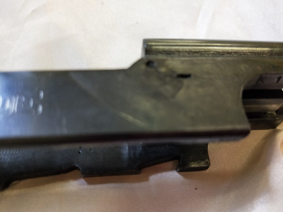

Just got my spare DES 32 slide back from the Laser Welder. Brilliant job.. They fixed up the previous cruddy repair job as well.
