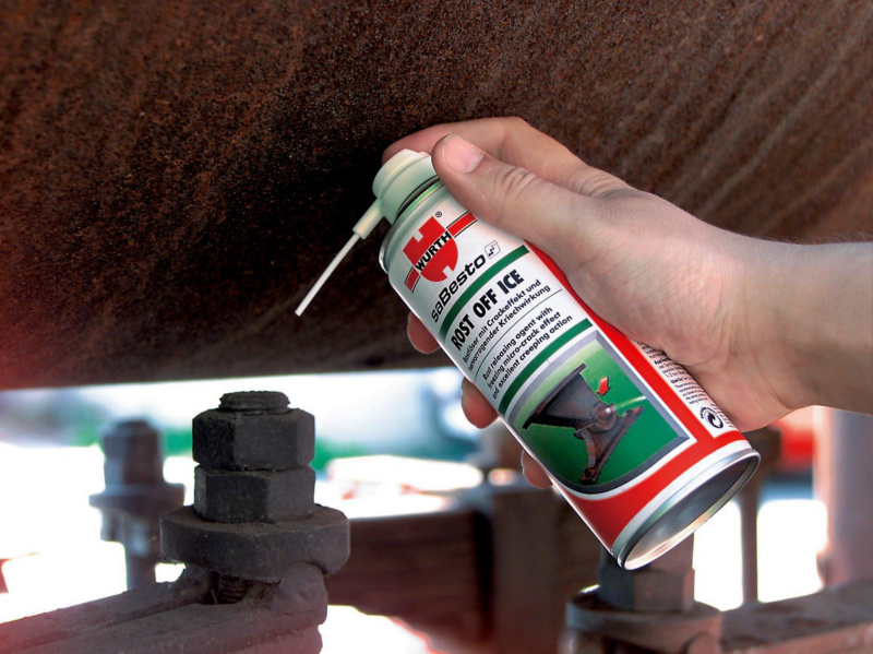

Here's an aerosol with extreme cooling (Würth Rost Off Ice) I use to release stubborn screws that won't budge.Gwhite wrote:You can also try freezing it to jolt it loose. A quick spray from an upside down can of aerosol "duster" will give it a good thermal shock.
Re: IZH-46 M Trigger screw.
If you read the fine print, the vast majority of aerosol freeze sprays use exactly the same chemical as the aerosol dusters. The dusters use the gas above the liquid, and the freeze sprays use the liquid by having a siphon tube that goes to the bottom of the can. You get exactly the same effect if you turn a duster upside down, and you can buy the cans of duster all over the place. Freeze spray tends to be more of a specialty item, and often costs a lot more. I buy the duster stuff whenever it goes on sale at the local computer store.
