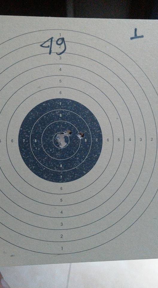

Why your grouping smaller when pressure getting low. Its easy..you shoot, shoot..many shoot and you don't realize that your muscle memory start to develop and your group smaller after so many shooting. That's why you should adding more dry fire than live fire. Steyr has recoil dumper you will never realize its recoil. I shoot morini 162Ei right now. Its hasn't recoil dumper, it has recoil kick harder than your steyr evo but i able shoot 50/50 , 49/50 sometime. And it still on factory setting. I am just recreational shooter, not a pro.
My other shooter some said, my pistol shoot so loud different than other. maybe it has too much velocity. But i said " I don't care" i'am good with this. I am just shooter not a gunsmith shooter who always tuning his gun when he shoot bad Lol
this i shoot with my morini factory setting,

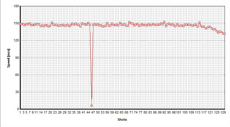

A theory is just that until you prove it. Crono it and see If there is a velocity variation between 200 bar at the start of the tank and down near 60 bar at the end of the tank. If there is a significance variation, do what Rover suggested and mount it in a vice as Steyr suggests with a quality pellet like a RWS R10. My Steyr only starts to slow down around 50bar.

LP10 chrono results attached, did not start at 200 bar so shot count not correct for a full cylinder.

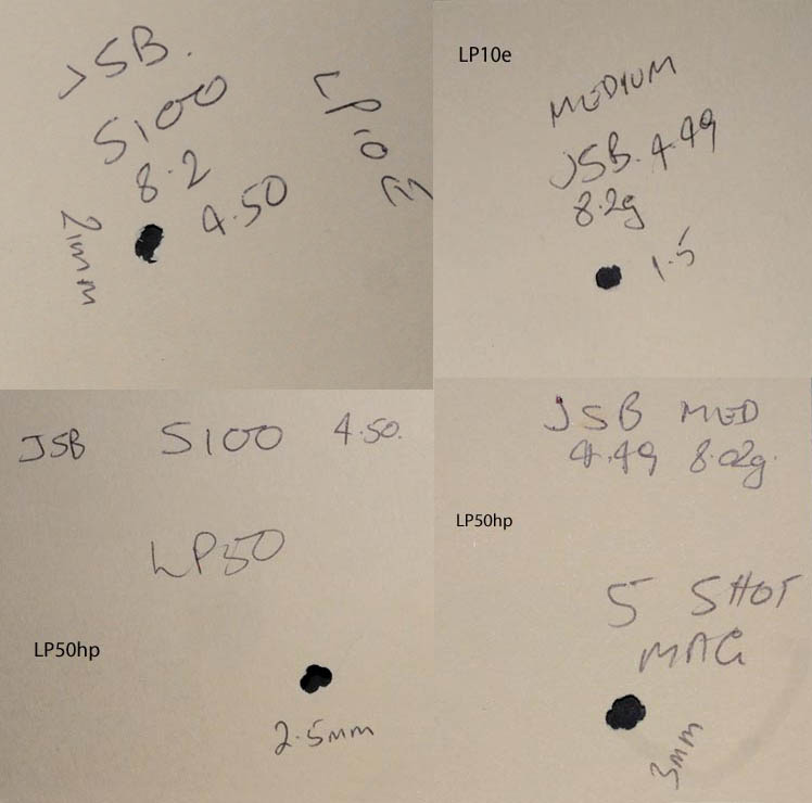

Put my LP10e and LP50hp in vice on the weekend. JSB med 8.02gr 4.49mm and JSB S100 4.50mm used in both. LP10e does 155 m/s with the JSB med pellets and the LP50hp does 220 m/s with the JSB mediums. The S100's have nearly the same five shot group size, they do not seem to care how fast they go. The JSB mediums do not work quite as well, hardly call it a terrible group. My mount for the pistol could be improved. I do not expect to get the test target sized group when I test pellets. I also do not expect the LP50 to have quite as good group as the LP10e, as it is shooting from a magazine into the barrel. One for Rover, RWS basic LP50hp.

As the cylinder pressure drops there should be no change to velocity, or recoil, due to your gun having a regulator to allow for this presssure change. Your velocity charts back this up.
