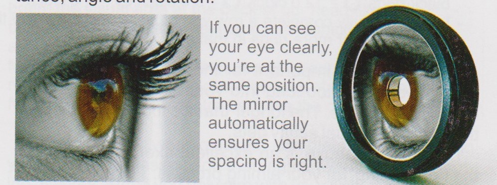

The mirror doesn't slip on, it screws on. You're supposed to NOT be able to see your pupil. You can still see the rest of your eye "around" the pupil (exactly how much depends on how close you are). I used one for ages, have recently removed it to try a coloured ring instead. I think it's also a good aid for a new shooter to help teach them eye alignment.

btucker, I lined up the hole in the mirror to be concentric with the reflection of my pupil.

It should look like this.

Thanks TH. Reason for confusion is here is 10.9 (store) description of what it does and how to use it: " The Mirror is a tool to teach and confirm proper head position and sight alignment. It fits on your rear aperture and reflects the image of your eye back to you...IF and only if your eye is not positioned correctly. If your eye is in the center of the rear sight, your sight picture will be fine and you won't have your own eyeball staring back at you. If you're mis-aligned, you will!" Different for sure.
I taped a friends mirror onto my anschutz 9530 and all I could get was that my eye and pupil was nowhere near low enough to center in this mirror. Removed the entire cheek stock and still was nowhere near low enough to get the hole even near my pupil. I do think I had the mirror pretty well centered on the back of my eyepiece. To get my eye to lineup I'd have to raise my rear sight 20-30mm more (already have 28mm on it, and never use my cheek piece....
