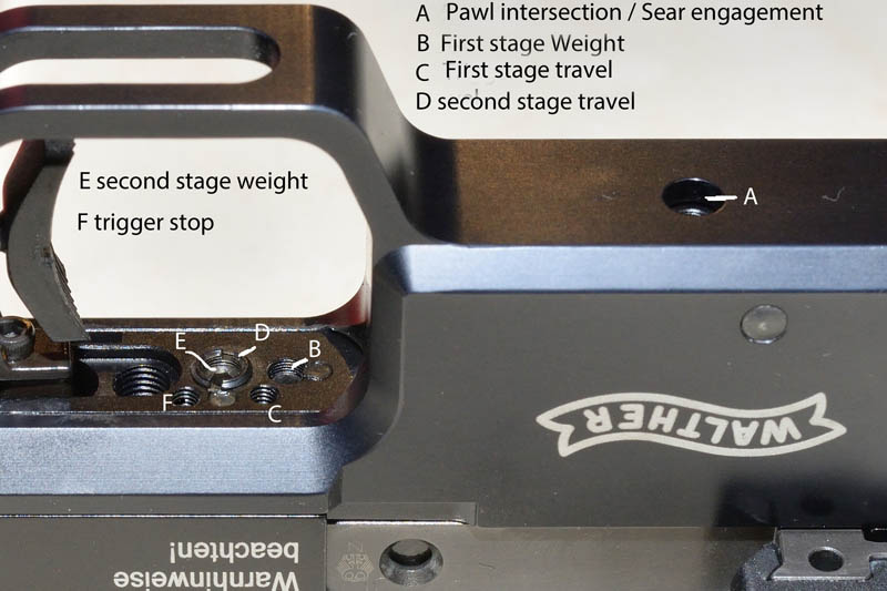

Pawl intersection is the sear engagement. If adjusted it will it will need the first stage travel screw adjusted as well. The side view of the trigger gives a good view of the mechanism. If screw A is adjusted clockwise and C is not, you may end up with a shortened first stage and lots of slop at the start of the travel. A ''three'' stage trigger. Screw C needs to be adjusted anticlockwise to get rid of most of the slop before the first stage. Adjust screw C the wrong way or too far and the trigger bar, the red thing, will not engage with the sears after the shot is fired. Do not adjust if you do not understand the interaction between the two screws.
Total trigger travel cannot be reduced to far otherwise the pistol may machine gun. Walther suggest 2 to 3 mm total travel.
Trigger power refers to the second stage weight. Adjusted with hex screw E on my picture. Does not interact with other adjustments.
Screw B is first stage weight adjustment. Does not interact with other adjustments.
Slotted screw D impacts the amount of second stage travel, or the complete lack of it. ie roll off trigger.

If you adjust the pawl intersection with screw A and do not adjust screw C at the same time you will reduce the amount of the first stage travel. But the total travel of the trigger will stay the same.
Just say before adjustment total trigger movement is five mm. This is made up by a small amount of trigger slack that is needed to let the trigger reset when it released, first stage travel and the second stage travel and travel to the trigger stop.
After adjusting screw A you will have an increase in the trigger slack, a reduced first stage movement and the second stage plus trigger stop will stay the same. Total trigger movement is still 5mm.
Screw C has to be adjusted to remove the trigger slack caused by adjusting screw A. If you adjust C too far the trigger will not reset when you release it. To little adjustment means unnecessary slack before the first stage.
If you take 2mm of travel off the first stage with Screw A you will need to remove 2mm of travel from the slack with screw C.
Screw C adjusts the interaction between the red trigger bar and the green pawl.

Gwhite wrote:From looking at the diagram, it looks like all you have to do is adjust Screw A to reduce the length of the first stage. Adjusting the pawl/sear should be unnecessary, and generally shouldn't be touched unless you know what you are doing. It is very easy to make the pistol unsafe if you reduce the pawl engagement too much.
Screw A is directly adjusting the pawl/sear engagement. The Walther trigger is no different to the Pardini , FAS and many others in how it works. These pistols have heavy sear / pawl engagement. The first stage travel is just moving the sears / pawl to a point just before release when the sears / pawl contacts the second stage adjusting screw spring mechanism.
The Pardini and the FAS plus others need the trigger bar adjusted to let it reset and not have too much slack travel..
Walther state in the manual that a minimum off 2mm of trigger travel is needed otherwise machine gunning is possible. How much sear / pawl engagement this translate to I do not know.

I do not have your pistol in my hands so I cannot see what makes up your trigger travel/ weight. I have to assume the terms you use are the same as mine.
My Walther has
Trigger slack / free play .5mm and minimal weight
First stage travel 3mm approximately 500grams weight
Second stage travel virtually nil another 500 and a bit weight.
Small movement after release to trigger stop.
If your pistol has minimal trigger slack and minimal second stage travel like mine you can only reduce travel by removing first stage travel.
You need to reduce pawl intersection first Screw A clockwise. Then screw C anticlockwise.
