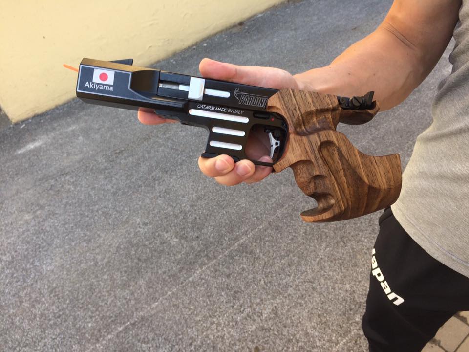

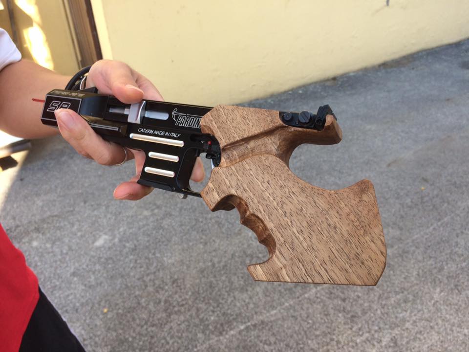

just two grips made by Vito Spilotro

In 10m AP there's a rule stating that the grip may not allow the thumb to bend down past 90°. Is this not the case in the sort of pistol competition where these pistols are used? Nice looking carving in any case.

Found this rule. "Any ***upward*** curvature of the heel and/or thumb rest and/or a downward curvature of the side opposite the thumb is prohibited. The thumb rest must allow free upward movement of the thumb." In those pictures the curvature of the thumb rest is not "upward", imo.

I'd rather study the other side of the grips than the rulebook... Wonder who studied whom, between Vito and Ralf Schumann, seems to be the same idea of positioning the hand and use the thumb.
Interesting that some people assume others to have ignored the rules, even when looking at the work of the grip guru of one of the most successful companies in the business. Might be one of the reasons why nothing interesting goes on here anymore.

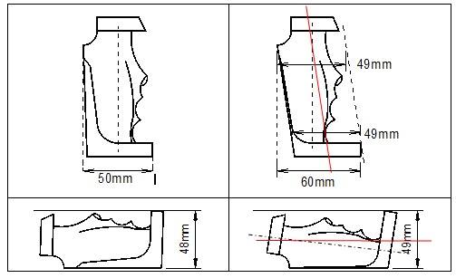

There is another question. And I do not know the answer.
A) On the left (see the attached picture) there is a standard grip, regular, every "section" of the grip is < 50 mm wide, also the ***projection*** of the grip at the bottom is = 50 mm wide. Of course the grip fits into the box.
B) On the right (see the attached picture) there is another grip, a bit "angled", every "section" of the grip is < 50 mm wide, but the ***projection*** of the grip at the bottom is >> 50 mm. Also this grip, of course, fits into the box.
C) Now the question: are both allowed?
Dr. Jim
Posts: 269
Re: wood sculptures (grips)
Post by Dr. Jim »
Using pictures, drawings, projections is essentially wasted effort, my friend. The measurements are set for THE BOX that the pistol has to fit into so the utilization of orthogonal projections is not useful. The shape of the grip can the severely slanted to one side such that you might get a 35 mm palm shelf - the only requirement is that the top of the shelf may not be less than 90 degrees to the vertical, I.e. It may NOT wrap up around the hand, similarly the thumb rest must be flat and no less than 90degrees to the vertical . You are not going to get the ISSF to change. Accept it and move on.

Sorry, I got carried away. The answer you want is that if it goes into box and the angles of palm and thumb rest are ok, the pistol is legal.
