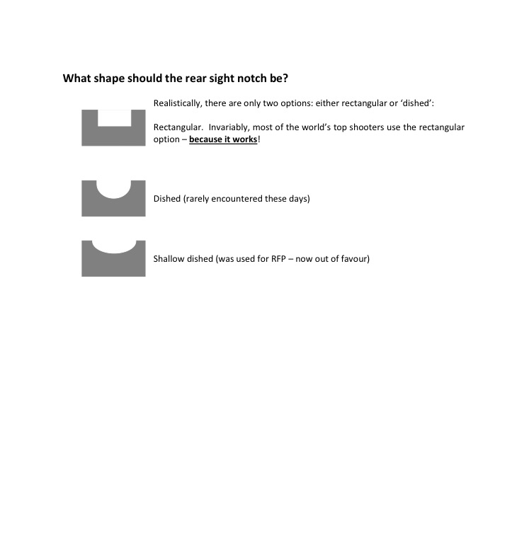

Re: Sight picture?
You should have stuck with the first pair. You are not supposed to be looking at the target at any time or in any way...should be blurry and even distorted.I have tried using those for shooting. the front sight is perfectly focused but the target is so fuzzy it doesn’t appear round.
- deadeyedick
- Posts: 1204
- Location: Australia
Re: Sight picture?
Here is what Rover was talking about. Pictures 2&3. I am sure that even not used as much nowadays the dished rear notch will still work as well today as it did in the past.buy a 3/16" chain saw file at the hardware store and hog out your rear notch until you've cleaned it up to a half moon. It worked well enough for the Russians to kick our asses for MANY years.

Re: Sight picture?
World Champion Don Nygord said:
"As a follow up on the shooting glasses tip, we are going to talk about the sights themselves that you are trying so hard to see. The most common type of “iron” sights, those required by international shooting rules, are the “partridge” type — a square rear notch and a square post front. There are other types — notably the “U” notch rear sight — used by some of the top European shooters. The “U” notch is interesting in that if you make a windage error in aligning the front sight with the rear, it shows up as a change in the height of the bar of light on the error side, as well as a change in the width of the light bar. See figure 1. I used this type of rear notch for several years when shooting Free Pistol, including when I set the National Record of 574."
