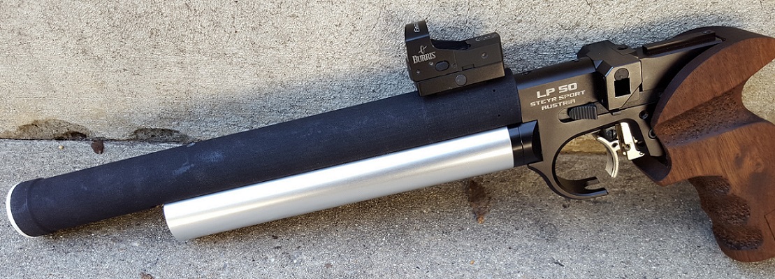

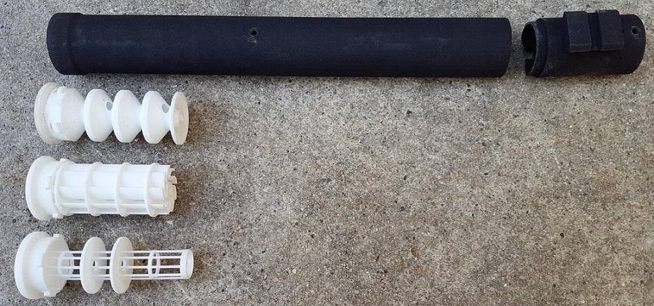

While were getting our LP50 geek on, here are a couple pics of a quiet shooting accessory I designed and had 3D printed.
Went with a full shroud to cover the barrel vents. It has an integrated picatinny mount.
Clever! Is this for some stealth backyard ops?
Would be very interested in Steyr's response.
Thanks! With it i don't disturb anyone and it was a fun project too.
