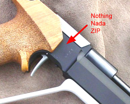

As a former Pardini dealer (back in the Pardini-Fiocchi days), I can confirm that the K58 never had a dry fire feature, anywhere. The CO2s (K60, K90) had this feature but not the K58.stuart wrote: There are a few things I do not like, on the gun I have there is no dry fire mechanism, in the USA the importer modified some K58s before the were sold so this might not be a problem over there. You can adjust the width of the rear sight on modern pistols and even FWB early pistols but not on the K58, as light levels change I do like this feature.
Rover will tell you that in exchange for the DF feature, with the K58, you get a cocking lever, instead...

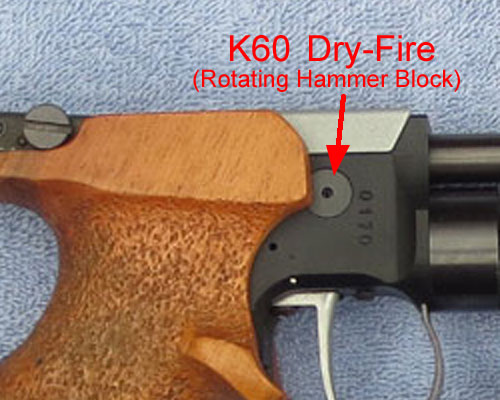

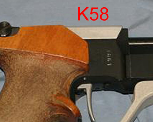

I am curious to understand how this later K58 dry-fire mechanism works. Can someone post a picture?
As mentioned before, the Dry-fire feature on the K60 is a physical hammer block... In the picture below, there is a cylindrical steel part, on the RT side of the frame. Internally, part of the cylinder is milled away. In operation, the cylinder is rotated so that the milled portion is parallel with the Hammer cavity. This allows the hammer to complete its travel and fire the airgun. To dry-fire, the cylinder is rotated to block the full travel of the hammer, preventing it from firing the charge. Cock the pistol and set the hammer by raising the loading cover. In dryfire, you get the sensation of the hammer flying forward, although blocked before hitting the valve pin.
The K58 does not (from the factory on the early models) have this physical modification to the frame, including the rotary block. Thus, it can't physically mimic the forward flight of the hammer in dry-fire mode. Yes, I agree that opening the loading port cover cocks the pistol hammer back on both pistols in standard design. But with hammer cocked, I would like to understand how the hammer is stopped on the K58 in "dry-fire" mode.
- Dryfire.jpg (50.55 KiB) Viewed 5461 times
- No-Dry-fire.jpg (30.35 KiB) Viewed 5461 times

Pictures don't lie... For the several years that I sold/serviced Pardini K60s and K58s (1987-1995) the frames were not identical as shown above. Nor were the "switches" identical, because the K60 was the only model with a visible dry-fire "switch."Rover wrote:I don't know the answer to your question (imagine that!), but the K60 and K58 switches were identical, as were many of their parts.
Others have posted that the K58 dry-fire was an aftermarket modification, or a later model. I would simply like to learn how it was accomplished.
And if it became available on a later model (from the factory), what year did it first appear?

Look closely. The K58 does not have the rotary switch that the K60 has... (ie., the frames were NOT manufactured identically at the factory.)hundert wrote:they look identical to my eyes

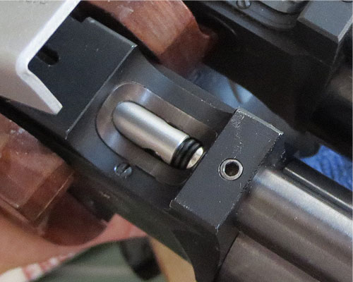

By the way, those of you still shooting K58 or K60s, you may have found the weakest link in these pistols is to be able to find that specially-made, cream-colored seal for the bolt probe. Made only by Pardini, it is a bespoke part that is not only rare, but expensive. Worse, the last factory replacement I bought from a well-known US distributor was dry-rotted on delivery. I suspect these are long out of production.
Accordingly, I have discovered an alternative solution. You can replace the factory seal altogether, with a pair of 1.2mm x 3.5mm common o-rings. (Metric 1.2x3.5 BN70). They work great for either pistol...
- 1.2x3.5BN70.jpg (39.25 KiB) Viewed 5399 times
