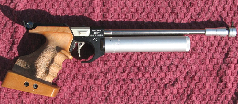

Nice to see we both have ancient CO2 powered Steyrs. My LP1-P weighs 883 grams with a full load of CO2. Of course, it's missing 105 useless grams of decorative barrel shroud/sleeve.

As noted earlier, this LP1-P CO2 weighs only 883 grams with full load of CO2... Short of an LP2 Compact (PCP), I don't know of any Steyr that is lighter...
