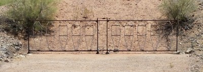

Yup, and plenty of old ranges still have the legacy target frames in use. This photo is from the Phoenix Rod and Gun club.

I started shooting RF in 1986 on the "torso" targets, but all of the frames back then were full height to take the coffin lids.
I remember the working bee at my club when we cut the frames to take the smaller boards, my lack of overhead welding skills were clear for all to see that day!
