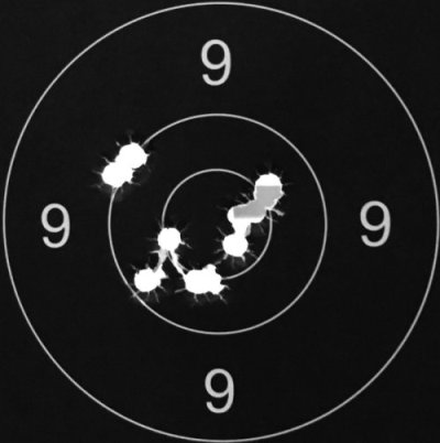

The gun qualifies (P210-6 9x19). Ammo unfortunately not (handload based on Hornady XTP 115gr, a jacketed projectile).
According to factory it can do even better. My control target shows 40mm group shot at the distance of 50m. Trigger pull is quite acceptable (3lbs), so the only issue is the right ammo.
Ah, and again - not a very common gun :-)

The factory P210 will do that all day, but with jacketed ammo, its a different story with lead ammo.cnnhead wrote:The gun qualifies (P210-6 9x19). Ammo unfortunately not (handload based on Hornady XTP 115gr, a jacketed projectile).
Centrefire we cannot use jacketed ammo, must be soft lead or similar.
The factory did make a 6" lead barrel but it will only fit the 5" frame (barrel threaded for the old -5 model
not the LS).

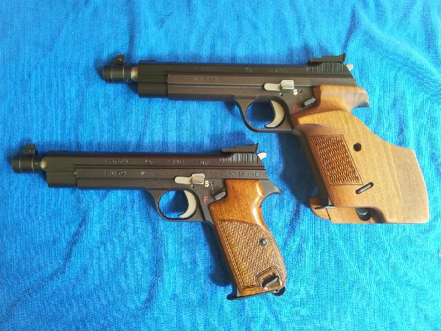

Here are my two 210-5s.
Both have the factory lead barrel fitted ( "bleilauf").
Both were purchased NIB from Switzerland - The one on the right is still unfired and fitted with ortho grips directly from the factory - the one on the left has had nor more than 25 rounds through it...
BTW - the pictures of the 210-5 in preceding posts are from swissdagger.com - where it was listed for sale.

Why??? Are you keeping them in good condition for when the government confiscates them, so they look good going into the crusher? I'm kinda hoping that my P210 is worn out when I'm finished with it!Leon wrote: The one on the right is still unfired and fitted with ortho grips directly from the factory - the one on the left has had nor more than 25 rounds through it...
