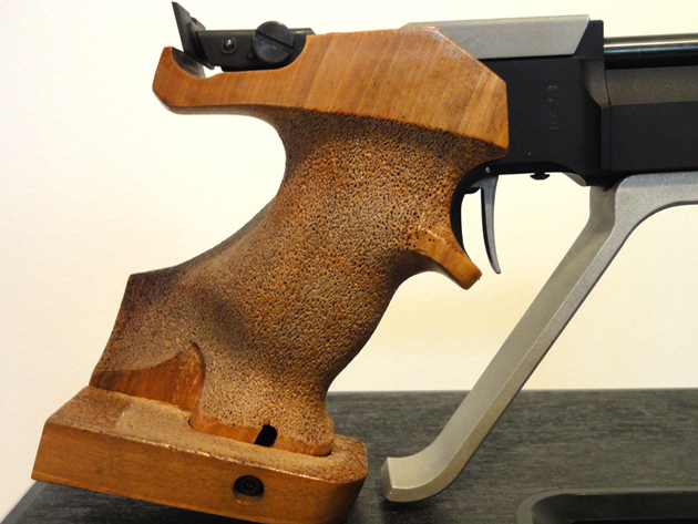

I would give just about anything to have back that grip that was on my Pardini K58. The first moment I put it in my hand, it felt like it disappeared, exactly fitting every crack and crevice. I saw on your websight that you take measurements differently then others, accounting for all the way back to the wrist, a very good thing. One thing I didn't see is how you measure the fullness of the hand in the palm area, or the depth from front to back. Nils does something like that, but his method doesn't seem to cover it all either. Would you accept a putty or whatever exact mold of my hand to work from? It seems to me that that is the only way to custom fit a grip exactly to someone's hand.
The standard Walther grip is $178.
Pic below of my beloved...but gone...sniff, sniff,... K58 grip.

The final product...........
LP400 with Rink grip LRF7. This is about the fourth grip I made/got for this gun.
Rear sight reduced overall width by 5mm (milled 2.5mm from each side of block and sliding leafs).
Seven degree offset grip but you can see from above that it is twisted back almost seven degrees to neutral. This is the way it works for me.
Rink large grips always need palm shelf bottomed out for me - hence filler piece glued in the gap above the shelf.
Fingertips don't touch the grip on the offhand side.
Added a weight bar like Anschutz LP@.
Trigger springs changed and sear stoned and polished.
Walther GSP trigger shoe mounted on a bracket whereby whole shoe and mount assembly can be removed without need to dismantle trigger bar above it.
