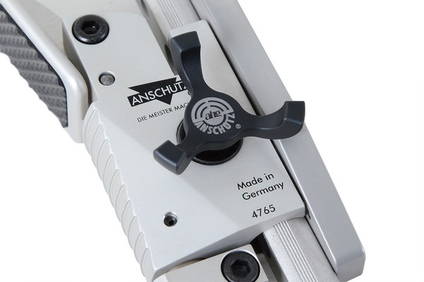

The newer aluminum stocks like the Anschutz Precise allow the shooter to make a lot of adjustments without the use of tools. Anschutz offers a few knobs that can be installed on the 2213 series stocks that gives them more quick-adjust functionality.
The older 18xx and 19xx stocks aren't nearly as adjustable as the 21st century offerings, but I'm just curious if anyone has come up with DIY knobs for some of the adjustments such as the cheek piece height adjustment or the vertical / horizontal butt hook adjustment. (I've seen the A4767 knob that Anschutz sells for the 4762 hook, but I'm curious if I could come up with something cheaper at the local hardware store).

Spend the $25 at Champions Choices and don't look back, you wont regret it.
Every time I change my butt plate from prone to offhand, I wonder why I didn't buy the knob earlier.
