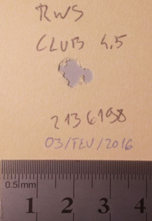

Third in line was the RWS Club (orange tin)
RWS Club.JPG (45.36 KiB) Viewed 13025 times
Better than the H&N Excite, but nothing to be proud of...

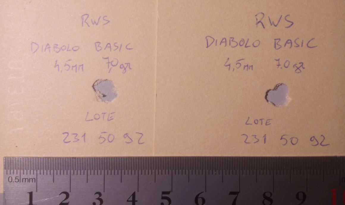

Finally came the RWS Diabolo Basic (green tin), in 4.5 and 7gr
I've tested these a few times, just to be sure. I was getting afraid my gun had developed a taste for the finer pellets in live...
Huge relieve!
I know the group size is larger than the R10, but they cost about 1/3 so I can´t complain!

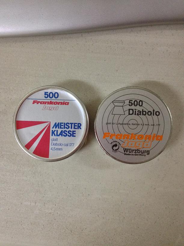

rmca wrote:First to establish a base line, I shot the RWS R10 Pistol, 7gr 4.49. Needless to say these gave me the smallest result of the four I´ve tested, although they cost about 10-11€ a tin around here!
That price seems quite reasonable, in the U.S., they cost around $15!. Here in Costa Rica, the most accurate pellets available for my match pistols (including my LP10) are the Frankonia Jagd wadcutter pellets. I thought they were manufactured by the RUAG group, but I found out they are made by H&N. They look very similar to the Finale Match pellets. If you can find them, give them a try.

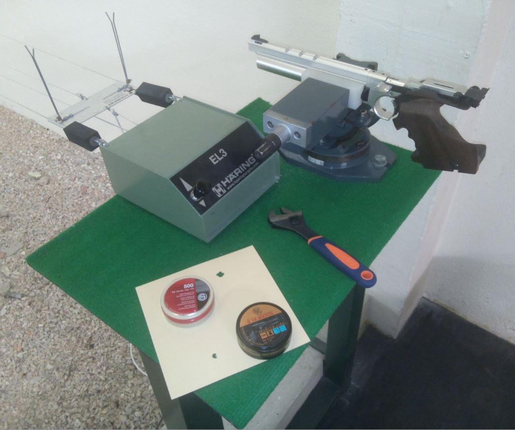

JamesH
Here's a picture of the test setup.
Re: Pellet Testing... AGAIN!
BTW I clamp my LP1 by the trigger guard, as recommended by Steyr. I was always afraid of crushing the cylinder.
Posts: 1231
I put the pistol in the vice finger tight, and then only about 1/6 of a turn with the wrench.
The vice jaws have a V in the middle, so I have four contact lines with the cylinder, which spreads the pressure.
I also try to get a bit of the pressure regulator on the vice jaws.
I have tried clamping it by the trigger guard, but it need to be clamped harder than I wished. Didn't like that feeling one bit...
Also, the pistol didn't feel as solid as it does clamped by the cylinder.
