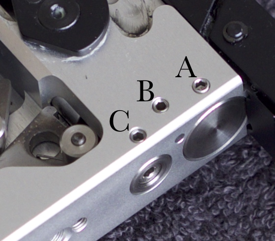

Haven't changed any of these from the original factory settings. After checking the grub screws, I noticed that B was loose. Is this normal? A and C are tight however.

Screw A - locks the Damper into the frame, should be tight (firm).
Screw B - is used to adjust the air bleed rate of the absorber chamber
Screw C - two screws (left and right) lock and hold the striker adjustment and end plate, also tight (firm).
Screw B should be loose as it alters the size of the bleed hole (just like a needle valve),
this changes the travel speed and hence feel of the absorber.
If you screw it all the way in, then the absorber will not work (pneumatic lock).

Many thanks David, much appreciated.
