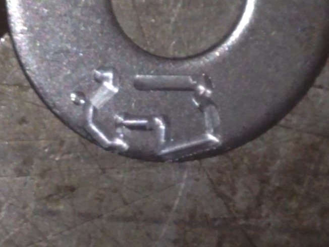

I cut the part on a CNC Horizontal boring mill using a #2 center drill, a 5/64 twist drill, and a 2mm 3-flute carbide endmill. The stock used was a flat washer for a 5/8 bolt. I haven't installed it yet, but the dimensions and appearance are correct. Before anyone asks, I'm not sure if I will make these for anyone but myself, but what I will do is post the program that can be used on any machine that uses a FANUC controller. The next hurdle is the plunger/spring assembly, but after this I think I can get there from here.

Bear with me. I left my thumb drive at work and won't be back until Monday. I should add that only the profile was done on the mill. The angles and radii were added by hand work, maybe 45 minutes worth.
Here is the part while still on the machine. You can see the small retainer left over. The part was cut away with a bandsaw.

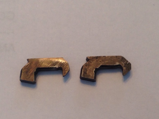

Here are the original and new parts together, original on the left and bottom. Also a picture of the new extractor installed.

What is the hardness of your donor material? Will it need to be heat treated?

Tzed250
Posts: 94
Joined: Fri May 02, 2008 5:51 pm
Re: I hope this works! Making a new IZh-35m extractor
Post by Tzed250 »
The washers are not hard, but they are tough. I will try it as is and determine if hardening is needed.
