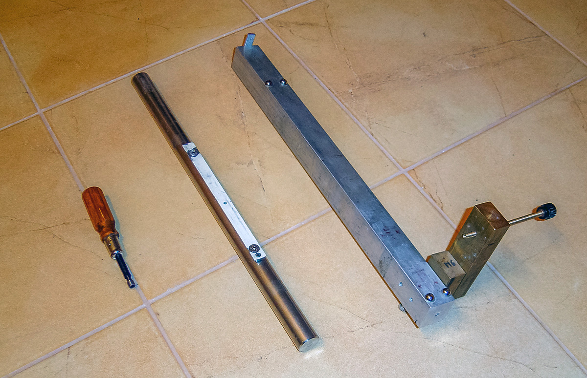

It was not my goal to start a new topic on "ammo tests", as there are many already running on TT. Just to notice the article in the ISSF News. As a physicist I like such projects, and even 8 years ago I made my own "clamps" inspired by Mr. Kudelin's idea. First, it gave better grouping than rigid clamps, but qualitatively changed nothing - better ammo from rigid clamps was better from the slider too. So...
Let's observe how Niccolo Campriani deals with the problem. As he is an engineer, after Rio 2016 maybe some interesting devices will be presented to the public. ;-)
My modest clamps are below :-)

All the testing I've done .... and to those I've talked to, the above statement just about sums it up.Grzegorz wrote:.... - better ammo from rigid clamps was better from the slider too.
It WILL be interesting though if a different answer comes out of Italy!
