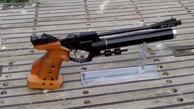

Does anyone know if its possible to convert a Baikal izh46m to a tank filled gun using the adopter used in the Baikal mp 672. They look the same except they took out the pump cylinder and added a screw on tank .https://youtu.be/Mqy_6ICUzLE

My question is why would you want to convert the 46M into a 672? With the money spent on the conversion, you could easily pick up a second hand CO2 pistol from Feinwerkbau or Walther. They are light years ahead in comparison to the 672...

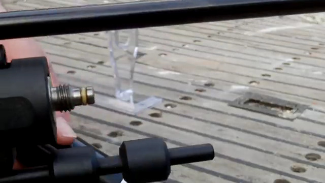

The izh 46m is easy to take apart and the pump cylinder unscrews and there is a seal at the bottom of it . It looks like from the video there is a threaded piece that screws into the tank . So all thats needed is the part that screws into the gun ,because the tank screws into that piece. I can't imagine the piece the tank screws into and a tank would cost very much at all. I think I'm going to try to order a tank and adapter and see if the threads are the same . If it works I guess I'll just keep it to myself. Your right why would anyone want to attach a tank that can shoot 100 shots with out pumping for probably less than 100.00 dollars . I got my gun back when it was 250.00 dollars so if I can convert it to a pcp with a tank and have a nice gun I can fill up and shoot 100 shots with for 350.00 dollars , Just call me stupid .

The fitting you show also has to include the pressure regulator to drop the variable pressure from up to 200 bar down to a fixed ~ 60 bar level. It's NOT just a funny looking threaded piece to screw the cylinder onto.

It's not only the pressure regulator, the valve housing where the air cylinder screws into is also different from the 46M. No way $100 is going to convert the 46M into a 672, unless you have your own lathe and you're capable of modding your pistol.

Would never work. The valve of the izh 46 can not hold pressure after the shot. Since the valve and the trigger components work together, it would take replacing everything. Except the grip. You can probably save the grip.

Poogi I see what you mean , once you pull the trigger the air valve stays open till the trigger cocking arm is raised up and locks into place. And it would have to close back right away after the shot or the tank would just empty out . I know when the gun is cocked part #17 moves is moved forward and pushes parts 30 and 32 where the o-ring fits in between . the valve spring part 13 and the main valve part #9 that fits inside the valve spring has a nail head on the end of it,and behind that is part 17 the valve stem . when the gun is cocked the valve stem is moved forward and slides up and across part #14 the valve sear and once its cocked in so far the valve sear under spring tension raises up and locks behind part 17 . When you pull the trigger the part #14 is forced down and away from the valve stem and the valve spring moves in the backwards position and the air is allowed to pass through. It doesn't move forward again until part #57 the bolt lever is raised up and forces every thing in the forward position again . So they had to add a self closing valve spring in that area. I'll look into just how the 672 valve spring works and find out if its interchangeable .
