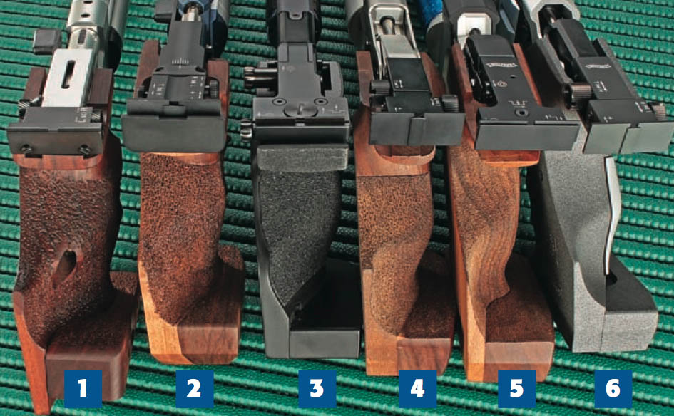

Few days ago in my club i took back in my hand a LP10 and had a few shots. I was immediately astonished by the fact that I had a much sharper view of the sights as compared to other pistols and this prompted a bit of thinking.
Steyr LP10 rear sight is simply a black blade, tilted downwards. So very sharp edges and no possibility of reflecting light.
Pardini adopts the same idea. Also FWB, although not as good as the previous two in my opinion, as there is a kind of double blade.
Morini 162 and Matchguns MGH1 (actually all Matchguns, as they use the same sights on all pistols) have a step in the rear sight and bending 90degrees from vertical to horizontal creates an edge which can reflect light. In the Morini it is a sharp bend, in the Matchguns is a rounded one, however the result is the same.
Obviously LP10 pays the effective simplicity with less possibility of adjustment as compared to Matchguns (adjustment of the hight of the visible front sight is limited and is manual, rather being 'click' controlled) .
So this should be one of the very few, possibly the only improvement I would wish to see in the Matchguns and in the Morini.

on the other day, I picked up a LP10 and the first thing I thought was the rear blade had screws are was not flat like my Walther LP400, lol...

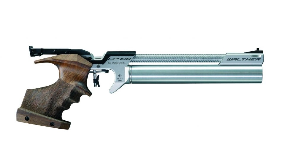

true, but as you can see from the pic you posted the blade of LP400 (n.5) is not as inclined as LP10.
So I would still rate LP10 rear sight n.1, followed by Parini: have a look at the sharp edge, the blade going deep inside the grip wood ( so no light at all).

and you have light under the blade!

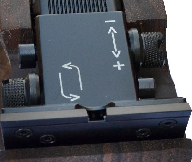

Actually the picture you posted from Visier is out of date. The current LP10 blade does not have those screws and is much better.
I don't agree with you. In my very little experience I found very important to adjust the rear sight depending on the light of the range where you are competing.

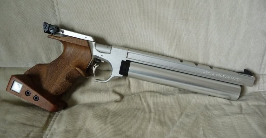

The new lp10 blade

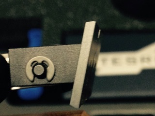

And from the side

Actually I am wrong... That is from lp2.
May be you are right... Simpler and cheaper blades look nicer !! :-)
I apologise

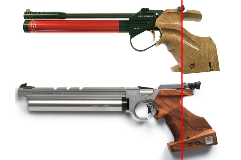

I have had an LP400 about four years (great gun, all sorted) and just bought a new LP10. I was surprised at the sight picture - the rear sight appeared sharper/clearer.
With rear sight on each gun positioned fully forward and using trigger blade for reference point the rear sight on the LP10 is about 15mm further away from the eye. The LP10 rear sight assembly is also not as wide as the LP400 (about 3-4mm). Taken together these add up to a crisper sight picture on the LP10 for me.
