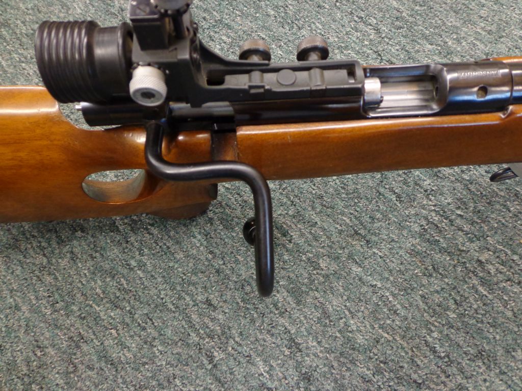

So I decided to get myself, finally, a .22lr match rifle. Instead of paying over $2k for a modern left handed rifle, for less than $900 I found myself buying a 1962 Anschütz Super Match 54 with a leftie stock that has a modified bolt that made it into almost a 100% a leftie.
Right side Bolt modified to be used by the left hand.  Bolt goes underneath the stock from the right side, then turns back up appaering on the left.

As for this left hand modification, this was typically done by a custom gunsmith for the owner. I think Gary Anderson might have pioneered the modification.
There were two ways of doing this, one the extended bolt handle that ran under the rifle, what you have and then later smiths would mill a opening on the left side of the receiver and attach a new bolt handle that operated in the reverse sense. A cleaner way of doing it.

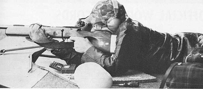

thats the EXACT same modification that Gary Anderson had on his rifle. its on display at the GA Air Rifle range at Camp Perry...

Gary Anderson 68 Olympics.

I am left handed. I have an Anschutz 1413 I purchased from Al Freeland in 1966 that originally had a left hand stock and right hand bolt. I also have an Anschutz standard rifle that I purchased in the early 1970s that originally had a left hand stock and right hand bolt. Both were converted to a left hand bolt by Bill Wiseman when he was an armorer at the U.S. Marine Corps Weapons Training Battalion, Quantico, VA, using a design that he developed for D. I. Boyd when Boyd was still shooting internationally for the Marines. When the bolt is closed the handle is up, and when the bolt is open the handle is down. This caued some interesting conversations with range officers.
I also have a Winchester Model 70 left hand bolt conversion attributed to Crayton Audett. So, custom conversions are out there. What you have looks like my recollection the the system that Gary Anderson used. Until relatively recently, things were complicated for left handed shooters. It is much easier to find a suitable left hand target rifle now.
