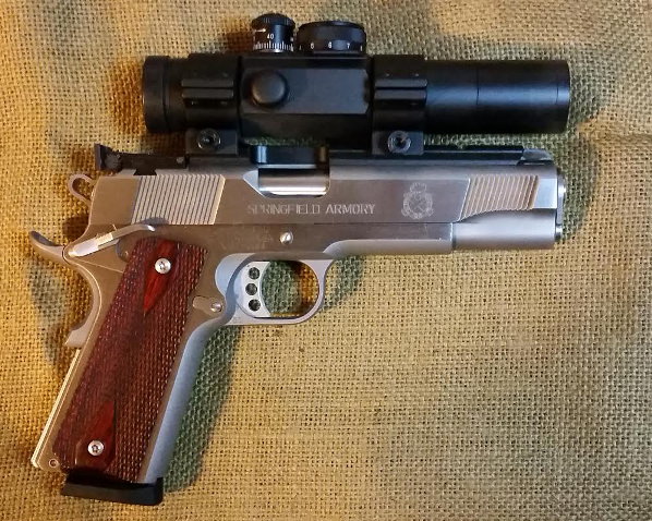

Well, this is what I did. I bought a Clark rail, shortened it so that I wouldn't have to make a plug to replace the rear sight, drilled another screw hole to replace one that was cut off, enlarged the ejection port to match the gun and cut a pair of grooves so that I could keep the dot as rearward as possible. I also dumped the rings that came with the Matchdot - they were taller and split vertically and I like this type better. I did have to change the spring to 13#. The whole setup ain't nearly as classy as some of the work I've seen on TT, but it is at least neat and effective.
A local gunsmith put a bug in my ear. He suggested that I install a Briley barrel and spherical bushing. I don't need the accuracy for competition, I just like to shoot. But I also like to tinker (and have a modest machine shop at my disposal). I'm not real keen on buying tools like a chamber reamer and headspace gauges that I'll only use once, but we'll see how rich I feel after I do my taxes.
