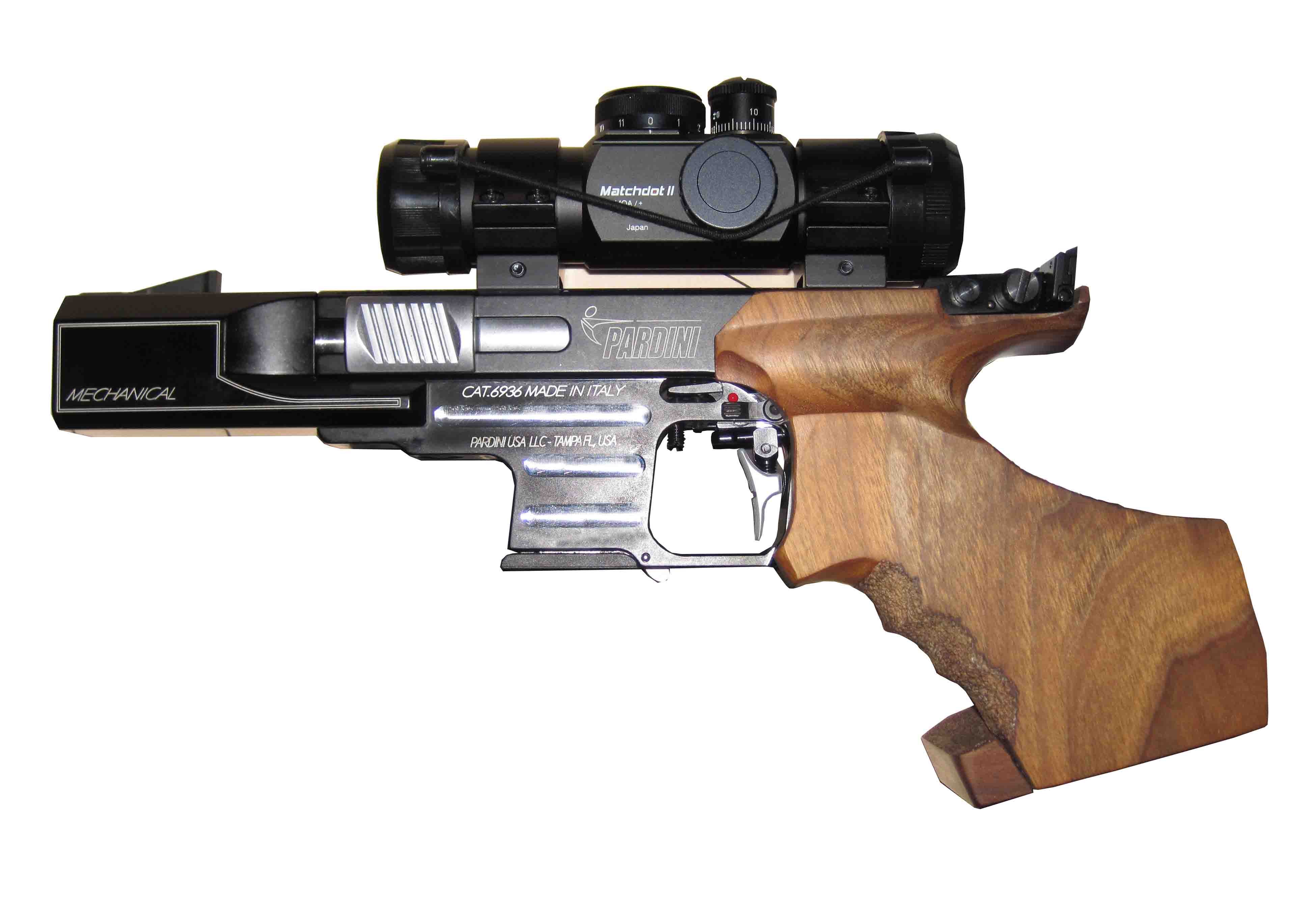

Try Pardini SP B/E version.

I agree with everyone: go for the Pardini SP Bullseye; I love mine. It is an equisite shooting instrument that runs like a watch. The folks in Tampa are very helpful and they carry a full line of parts incase you lose a screw. This purchase is one you will enjoy for many years. Dipnet
