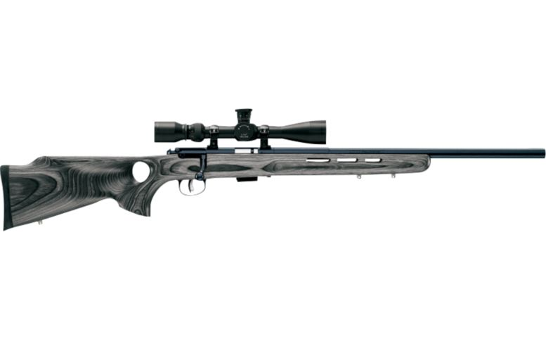

so my local gunshop has that same rifle shown in the picture above. are those actually snow sights that are installed? i did notice they don't have the flip up cover that goes over the barrel and sights. they've got a great price on it so just wondering what other mods for straps and spare magazine holders. can one just carry extra magazines in a pouch or fanny pack or maybe velcro's in a pouch on the stock or something? would the below picture also make a good rifle and could the snow sights be put on these, minus the scope? i checked one of those out and really felt pretty comfortable. i'm basically looking at getting back into shooting rifles again after many many years away and may even think about getting into competition outside of biathlon.
2whlrcr
Posts: 23
Joined: Wed Mar 12, 2014 7:24 pm
Location: Iowa
Re: cheap biathlon alternative....
Post by 2whlrcr »
Those Savage sights are not snow sights, but a decent peep and globe sight you can start out with. ESA offers a snow sight kit to retrofit the rifle for about $250?
