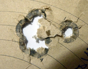

grupo 45.jpg (118.83 KiB) Viewed 6508 times
have no data speed but if the accuracy of PARDINI GT45 5 "in an Ramson Rest 25 meters:
Bullet 200 gr SWC linotipo 75% 25% lead (actual weight 195gr)
Powder: Vectan BA 10 - 3.3 gr
Sizin & LUBE 452 "
Mold LEE double cav. SWC 452 "
Between centers: 18mm wide and 14mm high
