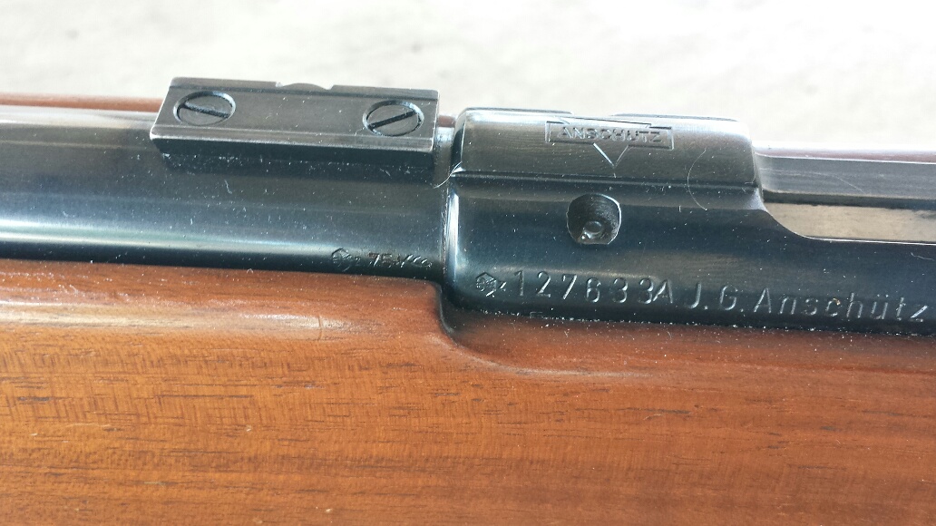

I am seeking some help to identify this rifle. I know from reading that it was made in 1975 based on the barrel. What I dont know is exactly what model this is. Dont think 1913 was around in 75 lol.

1413

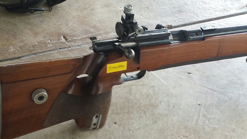

Based on the straight bolt handle and wing safety, I'm going to call that a 1413 in a late 1413 stock, since the early ones didn't have an adjustable cheekpiece, IIRC, and it appears to have the proper cutout for the wing safety.

Posts: 2086

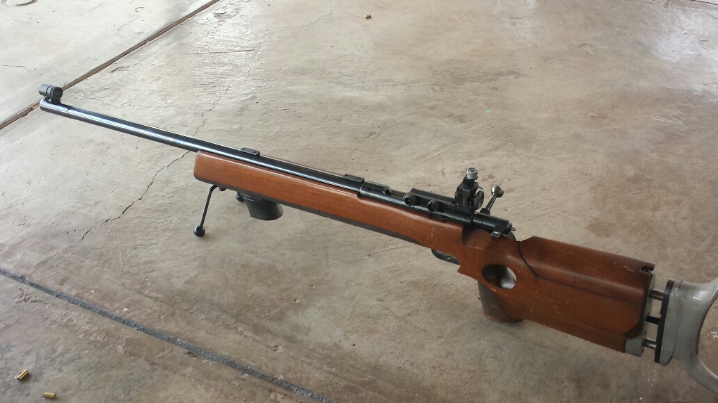

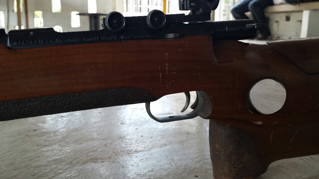

It's a 1413 Supermatch. It looks to be all original except for the buttplate, and handstop. Both are Anschutz articles, but the handstop is newer, no older than the 1980s, and the buttplate is of late '60s vintage. I'd expect a 1975 1413 to have a detachable hook.
The rearsight is the more desirable steel bodied 6702 International. The trigger is a single stage; depending on the weight setting 1408 D-U1 or 1411-U2.
It's not very different from the current 1913. The stock has slightly less adjustment, and the trigger is less sophisticated, but barrel specs haven't really changed. Stocks and triggers can be updated.

The serial number is right for the 1975 year. It appears the barrel has the 75 proof but can't be sure.
The single stage trigger would have been right for a 1411 which says the barreled action may have started life in a 1411 stock and it was later dropped into a 1413 stock.
The cheekpiece adjust is has the large knob on the side, appropriate for 1975 as well.

The odd thing about the buttplate is not only had they gone to the detachable hook by 1975 but the locking screw for length of pull I am pretty sure was on the bottom by then but there is clearly a notch in the back of the cheekpiece to allow for clearance for the nut and a screwdriver. (Yeah the early ones were slotted for a broad straight blade screwdriver.) Later models that screw was on the bottom. No big deal, the adjustment mechanism is still quite functional.

So it is safe to say that this rifle could shoot as good as any 1913 since the basic components ie barrel and action are the exact same in the year 2014 as it was in 75? All I really like is the trigger and the hook is really the notable changes. Does lock time really affect accuracy or consistency in any way?

A 5071 trigger will not screw straight onto a 1975 1413. The sear cross-pin will foul on the action, unless the pin is trimmed or a relief slot is cut into the receiver.

Dwayne JRA wrote:So it is safe to say that this rifle could shoot as good as any 1913 since the basic components ie barrel and action are the exact same in the year 2014 as it was in 75? All I really like is the trigger and the hook is really the notable changes. Does lock time really affect accuracy or consistency in any way?
Dwayne,
It could shoot as well as a 1913. Whether it actually does depends on the condition of the barrel, and also on luck. Barrels don't shoot accurately for ever; shooting eventually causes accuracy to deteriorate. A rifle that is almost 40 years old could have clocked up a round count high enough to reduce accuracy with only modest annual usage. Or it could have been fired once, and not used again. The less use it has seen, the better. Then there is luck; Anschutz make their barrels to certain tolerances, some are better than others regardless of age. I'd take a really good older barrel (especially if the "mileage" is low) over a new but so-so barrel. As 'Dude said Anschutz were making good barrels at this period.
As for the lock time, Anschutz clearly think it was worthwhile to decrease it, but you may not notice any effect in practise. The 1413 isn't slow, just not so fast as the 1913. I think any effect would be more noticeable standing than prone.
Ultimately it comes down to how well the barrel shoots. Does it meet your criteria for accuracy? If it doesn't then a new rifle, or a more accurate used one, would be better. Depending on local prices, buying the 1413, and replacing the barrel, may be more economical than a new 1913.
Yes, Tim is correct on this, it does take a few moments with a small grinder to trim the ends off the pin that holds the catch lever. Did it a time or two many years ago. Grinding the pins can be a do it yourself operation. (remove the pin for grinding or take care to keep grinding grit out of the trigger mechanism) If you go for slotting the bottom of the receiver it is best to have a gunsmith or someone with a mill do it. It is not a precision operation.

There appears to be some moderate wear on the bluing of the bolt handle. While no safe queen with less than a case through it the fact that the handle is not almost silver is sign the use is probably not ridiculously high. Does the present owner have any idea how many rounds are through it? Properly cared for, most factory Anschutz barrels from the 70s would go for 80k to 100k rounds before they started to lose accuracy. Then again, one screwup with a cleaning rod can wreck a barrel of any age.

The sticker by the bolt appears to be from the 2002 Commonwealth Games. Competition stickers usually suggest the rifle is accurate, but a national-level competitor will shoot a lot.
@Dude makes a good point about the bolt handle. Worn bluing is a sign the bolt has been opened and closed many times; some of those times will be from dry firing, but not all.
