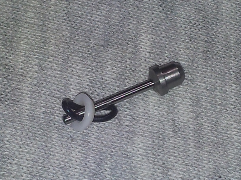

Is it leaking from the cylinder or from the valve?
One night when i was shoot my Lp400 was acting up with a couple of "soft" shots now and then. It then proceeded to dump the cylinder full of air through the firing valve.
Turns out the the o-ring that keeps the valve in place popped off and held the valve open.
The valve was reassembled and it was all OK. Took less the 20 minutes to disassemble figure out how the valve all fits together and re-assemble.
My Gunsmith has a new valve coming as sometimes they will leak as the valve can be damaged when this happens. Mine was all OK.
Attached picture is how the o-ring was lodged between the valve stem and seat when removed.

Posts: 1718
There is a new guide bushing assy that fixes the moving O ring problem on the valve.
The new valve is item #115 on the drawing, p/n 2798379.
Either fit the new guide bushing or carry out a repair using the old assy.
The O ring is easy to reseat and can be retained with a very, very small amount of superglue applied to the back face with a needle.
