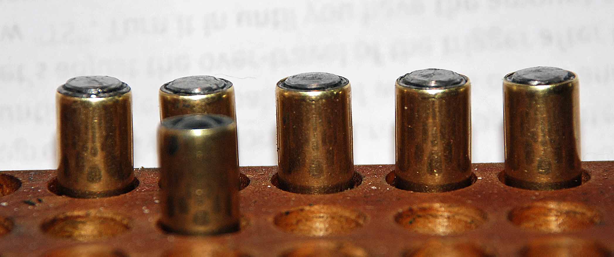

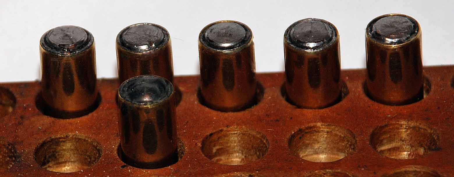

I would think about the .32 ACP change, however I just purchased 2000 rnds of Lapua brass, at a very good price....
attached are two photos of my cases, loaded with some second quality cast bullets... 5 empty new cases fit in the mag with no problem... They measured 0.9155/ 0.9160 on the average... ( should I cut these all down to 0.9112??)
My fired brass (I got with the gun ), is 0.9115/0.9120... the loaded rnds. are at the 0.9112 avg., I can get all 5 rnds in the mag, with a little of the dimple showing....
The back cases are my cast bullets and the front one is a 98 grn. Magtech.... Thanks for the help.... Tommy
