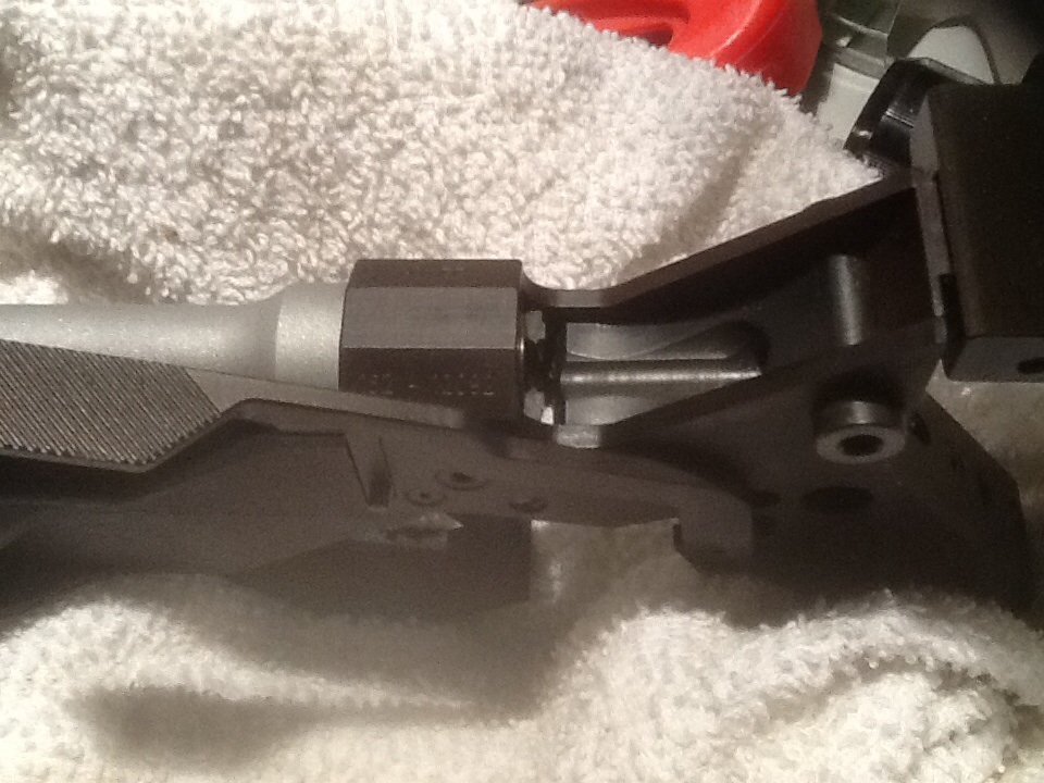

Pistol will not cock. Lever comes up enough to drop the block and push out the empty but will not go the rest of the way.
I recently lent this to a shooter who tried it out but could not get it to shoot. He was not pulling the lever back all the way. He told me that closing the breech was hard and he forced it down a number of times. This might be related I don't know.
Since returning to me I have taken it to the range and put 100 rounds through it. Worked fine.
Advice? I would love to dig into it but not finding a lot of resources to guide me.

I went ahead and ignored the caution not to remove the breech block unless it was cocked.
Yes the firing pin is broken. Pistol is several years old and I am second owner but the first owner only test fired it. I have 500 rounds through it. So disappointing that the tab on the pin broke off with so little use.
Now in search of one. Anyone have a spare they don't need any more?
