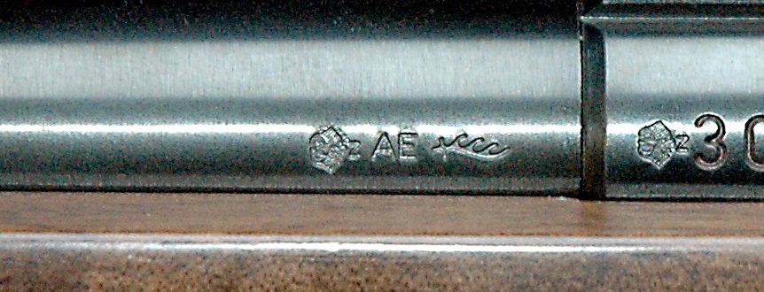

Hi all,
I have an old Anschutz 1813, how do I find out how when she was made?
I bought it second hand, can I get it from the numbers stamped on the action or not?
Kim.

Hi Kim,
on the left side of your barrel near the action should be some proof test stamps like shown in the picture below. They are from the German firearms testing organization. The two letters show the year of testing and also the approximate year of building in coded form.
The code for determining the age is as follows:
0=A; 1=B; 2=C; 3=D, 4=E; 5=F; 6=G; 7=H; 8=I/J; 9=K
The year of proof testing is described by the last two digits of a year, i. e. that a firearm with the letters ID was officially proof tested in the year 1983. AE on the picture stands for 2004 and shows the newer 1913. The 1813 was build from ca. 1979 till ca. 1986 or 1987. But the last is only a estimation from me.
Hope that helps. The 1813 was and still is a great rifle. I'm also a proud longtime owner.
Regards
Frank

Post by KIM »
Hi Frank,
Thanks that helps a lot.

Dear Tim,
as jet i have only seen the from Anschutz given serial numbers on the left front side of the action. The real stamp from the 'Beschussamt', this art of eagle sign with the letter N is normal on the barrel and also on the action, on the bold and on the bold handle. The coded date and the sign from the involved 'Beschussamt', for Anschutz is this normal Ulm and their sign is this art of antler, was on all of the Anschutz 18XX, i have so far seen, on the left side of the barrel. But for some older Match 54 i have also seen it on the action in the near of the serial number, as you mentioned.
Maybe they did (sometimes) a slightly different schema for theirs export weapons. We all know, Anschutz was at this time sometime slightly creative and there was also a slightly evolution of some details of the 18XX model range.
The legendary but not really well known special edition Anschutz 1984 Olympics was unique. The serial numbers were given from 1984001 to 1984999 and as i remember they printed also a special manual extra for that edition and on the barrel there was not the normal 'Super Match 1813' text, but something like 'Olympic 1984' or so.

Hello Frank,
I'm British not Australian, but we have met on the Target Shooting NZ site.
You are quite right, almost all Anschutz M54 rifles have the serial number on the action, and date, Eagle, and Antler, on the barrel (Eagle and Antler only up to 1960/61). Britain has accepted German proof tests for many years, at least while the Match 54 has been in production. The only Anschutz rifles I have seen without the standard German proofmarks have been where the rifle was rebarreled, or rechambered.
I have only seen one rifle with the normal markings reversed. At first I thought it was caused by a simple mistake at the factory, but the Anschutz website refers to other rifles marked in the same way. They explain that the Ulm proof house reversed the markings for a short period in 1985.
Thank you for the serial numbers on the Olympic 84. I knew that these had a special series, but not what the actual numbers were. My University club had an Olympic '84, though I never had the chance to shoot it. I think the vents cut into the fore-end were first seen on this model, and later copied onto the "standard" 1813 production.

Post by KIM »
Hi Frank,
[Are you that Kim from Australia?
Was an honour for me that i was able to help you a little.]
I am from Australia, (I don't know about that Kim)
I started shooting Prone in 2007. So i'm still new to the sport and learning a lot.
My old Anschutz which I bought second hand in 2008, the date on the the barrel reads (IC) so she was made 1983.
Who ever had it before me looked after it well, it's been cleaned that often that there is not much bluing left on the barrel. But she still holds a tight group.
Kim
