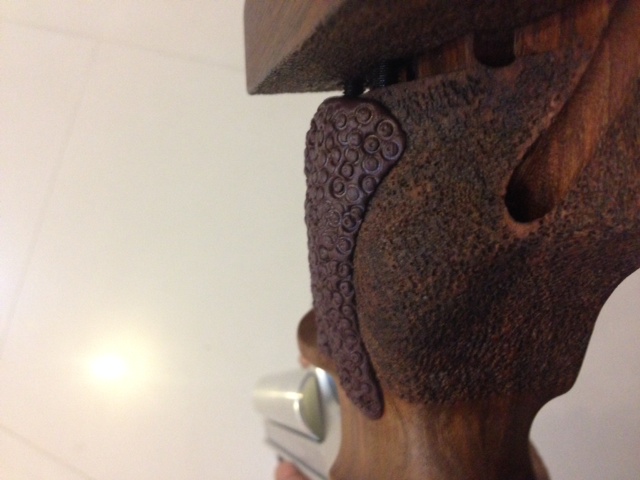

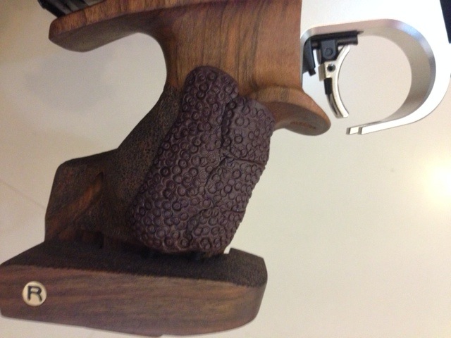

Newbie shooter (Last 6 months). Had been struggling with getting a proper "grip". Proper grip defined as - consistent holding of the pistol in exactly the same place and consistent trigger finger placement.
My original grip on the steyr LP10E was way uncomfortable to hold and hence took the plunge and invested in a Rink Grip. Sent the hand sketch to Rink and waited patiently for 8 weeks to get the same.
Huge improvement in the Grip but as people on the forum have said , no grip is exactly perfect for your own hand and needs to be customised. In my case (in hindsight ) should have ordered for the "Extra volume" option with Rink. If you have large hands this is the way to go.
To cut a long story short, after a lot of experiment , and research the best way to add volume to your pistol grip is "Sugru" some other members have already mentioned the same.
Sugru is the easiest to apply and customise on your grip and gives you a lot of working time ,as long as you continue to knead it to keep it malleable
Highly recommended for anyone looking to add volume to / modify their grip
The texture is achieved by just pushing the tip of a ball point pen into the surface of Sugru while it is hardening

I rather doubt spam. The Sugru community has grown very quickly over the past few years, mostly by word of mouth from one happy customer to another. A couple of other pistol shooters here on TT have indeed posted their grip modifications using the stuff. I used it to build up the thumb rest on my Rink grip, after a bit of colour blending with some pigment powders. It hardens nicely, like a hard eraser. Wouldn't recommend it for anyone experiencing gripping problems due to sweating though, as even stippled with lots of texture it's got a slippery feel when wet. For building bulk or shaping around the fingers though it's ideal, as he says, because it's so easy to form for about 20 minutes then cures by the next day to a permanent hard rubber firmness which can also be carved with a sharp knife or gouge if you've put on too much.
