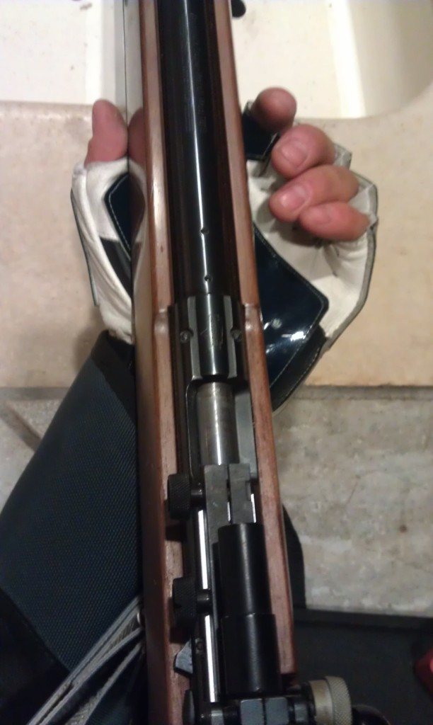

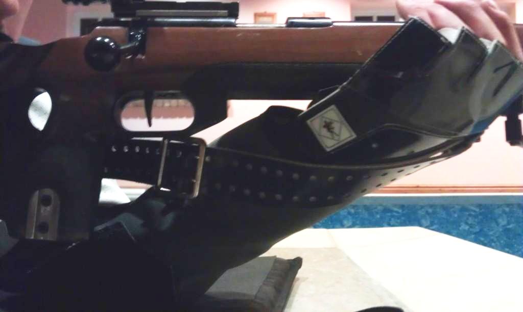

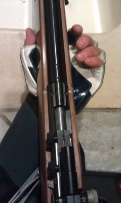

I have been experimenting this evening to try and reduce the pain in my wrist. I tried everything I could think of but nothing made any difference. I moved the hand stop, changed sling length lots of times, changed height of sling on jacket but nothing made any difference.
As a final thing to try I put a 10mm thick little block under the heel of my hand and this instantly got rid of the pain. The front of my hand was still touching the stock and hand stop as normal but the heel of my hand was now 10mm off the stock and more in line with my arm.
I still have a slight bend in my wrist looking from above but I can't see how this can be 100% straight due to the sling and the way it goes around the hand/arm. The sling will naturally try and bend the wrist a little am I correct in thinking this??
I think something that isn't helping me is the 1813 rifle Stock is quite wide and I have small hands. If the stock was narrower like a Precise stock I would naturally be able to get a hand position that was more inline with my arm.
Henry

Posts: 2097
Henry,
In the photos the sling is clear of the wrist knuckle, and your wrist looks fairly straight. However it looks as if the weight was all on the thumb web, not on the heel. Sometimes with stiff gloves (like your Monard), the hand doesn't bend backwards (this bend is OK), so the weight sits too far forwards. Your fix of a wedge would create contact with the heel, reducing the pressure on your thumb.
As noted above, if the stock feels too wide, make it thinner. You sometimes see Anschutz 1813/11 stocks slimmed down; a shooter named Jim Newby was known for the work some years ago.

I will be changing to a different stock soon which will be much narrower and not as deep. Which means I will be selling this stock soon so I don't want to start changing it really.
Tim
The side on photo is actually with the 10mm block I put under the heel of my hand, you can just see the black block in the photo above the logo on my glove. So the weight is actually on the heel of my hand in that photo even though it doesn't look like it.
The 10mm block really helped with my wrist pain so I think I will maybe make a wedge that is shaped better to my hand so I am comfortable and pain free for now until I get my new stock finished.
I think I have done some damage to my wrist over the last 4 months shooting through the pain. If I can get comfortable with some sort of wedge between the stock and my hand at least I will be able to shoot without pain and give my wrist chance to recover.
I will do some more experimenting.
Posts: 2097
Henry,
sorry, I couldn't see the block in there. I can see why the block would make a difference. It looks as if there is a gap between the heel of your hand and the stock (now filled in by the wedge).
If you look at the photos of Mario Knoeggler and John Hamon you can see that both have the heel of the hand touching the gun, although they have a pretty straight wrist (side-on).
