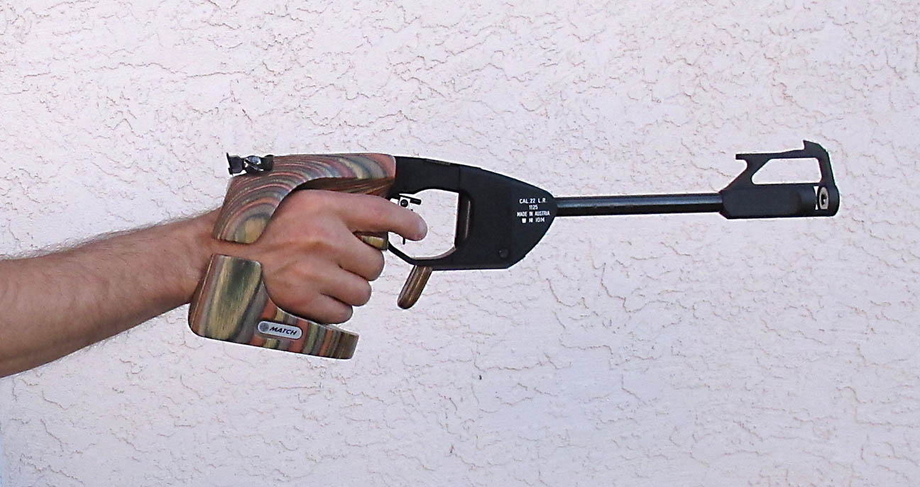

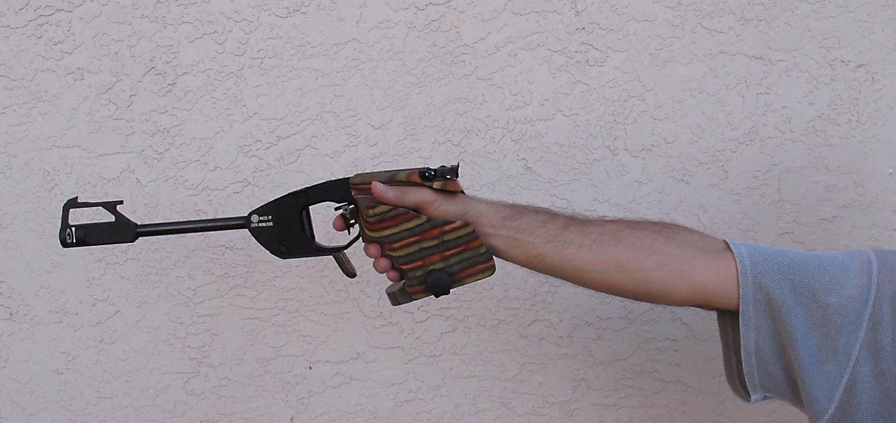

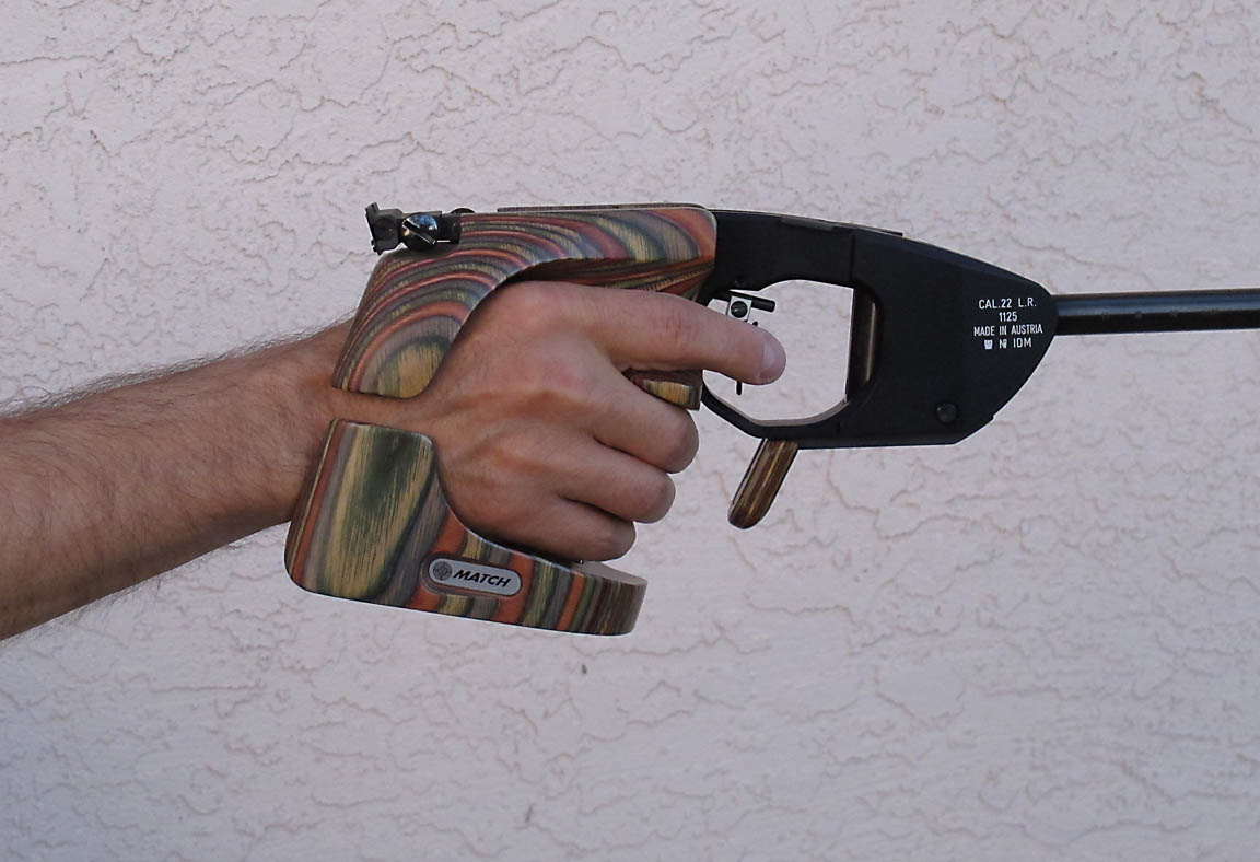

joel
Posts: 459
Location: San Diego, CA
Post by joel »
Here are some pics.
Joel
Posts: 1223
Your grip is touching your wrist. That's illegal.
You should have a line that defines the end of hand and the beginning of your wrist. Your grip cannot pass that line.
As suggested above, the only way is cut, dremel, sand or chisel...

conradin
Posts: 1999
Location: Basement.
Post by conradin »
I don't see any special modification on your Steyr FP2 that warrants it illegal, especially the grip part. The grip is not the typical older one, but there is little difference between the old and the new. Simply put, it is legal.
