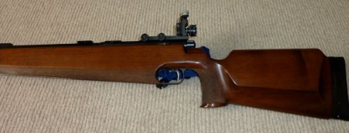

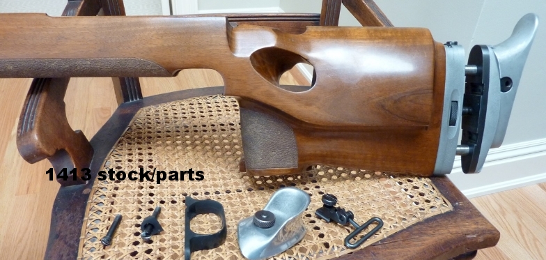

I recently purchased a lightly used 1972 1407 54 Match with spare 1413 stock for use in some club benchrest and smallbore matches. Got it at a good price and luckily have plenty of ammo to feed it for a while.

From the pics the 1407 stock is more of a 1974 style. The fore end on the '72 is deeper and less tapered.

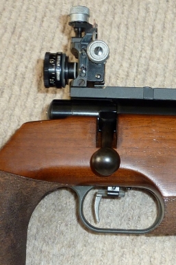

Also, the taper in front of the receiver does indicate this is the proper barrel for a 1407.

Quickly, your trigger is adjustable for weight, and take-up (the distance the trigger moves before firing). The weight adjustment screw is above the trigger blade (accessible through the hole in the stock); turn the screw clockwise to increase the weight. The take-up screw is in front of the trigger (reachable through a hole in the trigger guard) – turn clockwise for more movement.
