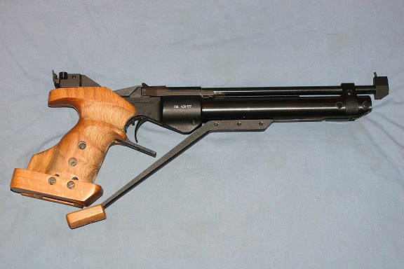

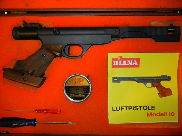

If you can get a chance to handle a Model 10 prior to making the purchase you obviously will get a better idea how you might like it. It is very well made and is certainly capable of top scores and the Giss system is very effective in eliminatating any sort of vibration or recoil not that the IZH has any issue there. If it has the newer seals in it as previously mentioned you should not run into any issues with it. I have had two and have not experienced any seal issues but they did have the newer seals (blue in color).
Resealed and in top shape these usually sell in the $400-$450, less if they are in less good condition. A rebuild these days is not cheap since RWS no longer has their own service center like they used to.
The IZH remains one of the best values in air pistols and is very reliable and simple in it's mechanics. Some people do find the IZH front heavy, more so on the 46M than on the original 46 but whether that is a negative or positive is a personal consideration. I usually like a forward bias in weight balance so they work out fine for me.
