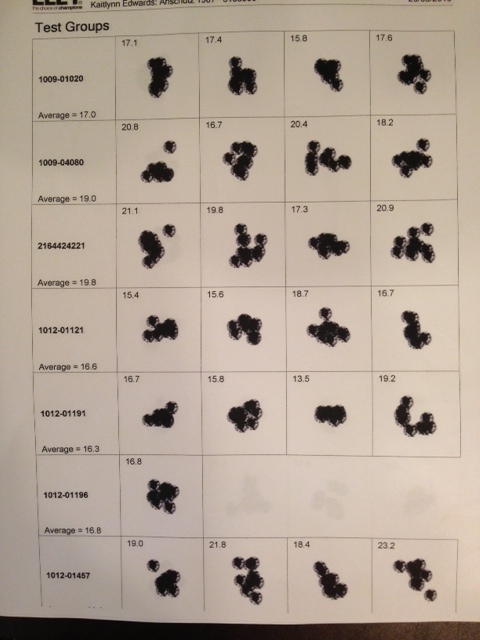

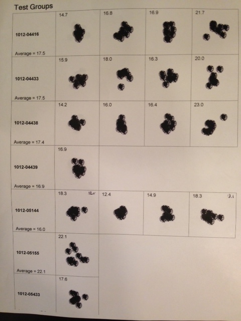

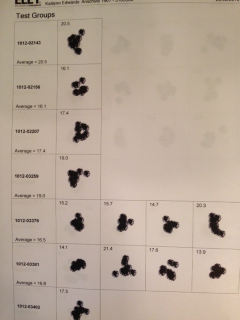

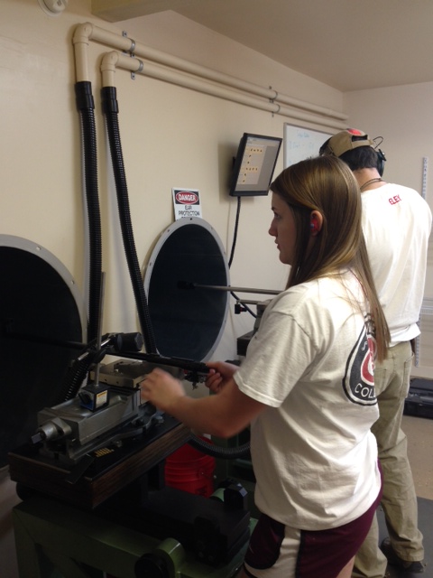

We took my daughter's rifle to the ELEY testing facility on Good Friday, what an experience.
The following pictures are of the results. Given this information, which lot would you choose and why. Her rifle is a 1907 factory barrel in a 1912 stock which is not bedded, which is something that I should probably do.

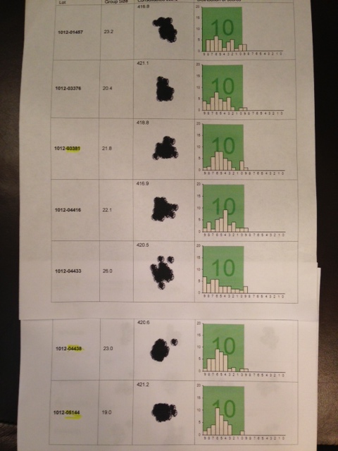

The last string of lot 3376 (20.3), the 2nd (21.4) and 3rd (17.6) strings of lot 3381 were shot in succession and I firmly believe that the barrel got hot causing them to open. Because, after we let it cool for about 8 mins and added a small battery operated fan blowing on the barrel it shot 13.9. I wish I would have thought to ask Jeff to go back and delete those two strings and shoot two more after we let it cool some more. Bonehead mistake on my part.
The 4438 showed some promise, but it threw a flier that was out of the 10ring. Other than the flier the 40 shot group was in the low 16's.
The 5144 was probably the best overall shooting a combined 421.2 with a 19.0 avg and all in the 10ring with most of them in the 10.3 to 10.7 range.
So, with the information above give me your honest opinion on which lot you would buy and rifle. Should I look at getting it bedded or even rebarreled over the summer.

I am sorry to say, but I would replace the barrel and test again.
At the very least, bed the rifle and hope that is improves- which it probably would.
Have you ever slugged the barrel? CAREFULLY pull a bullet from a 22 case and push it down the bore with a Cleaning rod, I am betting there is a tight spot NOT near the end of the barrel.
Those don't seem to be consistant enough groups, but just giving opinion as I have not tested at TX yet.

Of that bunch, it'd be the 4438, and ignore the flier, but I'd be rebarrelling that rifle ASAP, as none of it is consistent enough.

Bed and rebarrel. None of those groups are really competitive. Do not waste money buying ammo with the current set up as a new barrel may not have good results with the same lot.
As a side thought, did you check the torque on those action screws?

I don't think that the bedding is an issue. I may be mistaken (I didn't check), but I believe the testing apparatus uses the barreled action without the stock. If so, it needs a new barrel.

1907. Old barrel. Question I would ask: was it clean? I mean clean. How did you clean it?
If I was doing this I would take "lead away" to it while watching with a bore scope to make sure all the lead in the chamber was got out. Watching is important because "lead away" is fine grinding paste. Look for a buildup of lead right at the end of the cartridge. From there to where the bullet sits - once lead is dumped there - it begins to smear along the barrel. This is the stuff that needs digging out.
If I was really concerned I would even soak the barrel in mercury for an hour or so...............
Once this is done a few toos and fros with normal cleaning soln and pads.
THEN. Go back and do the tests again.
As you do the tests - and if you have a bore scope - check the area at the end of the cartridge. After 20 or so shots you will begin to see the lead ridge being built up. Then after about 60 or 70, the ridge begins to get smeared.
I would have a look at your bottom batch as well. It looks round which is a big help to begin with.

Forgive my lack of information. But, yes the barreled action is attached to the testing vise by putting studs into the action screw holes and then held on by nuts. Which, would rule out a bedding issue. We torqued them to 5nm the same as we use when attached to the stock. The rifle was purchased new in December of 2010 and the round count is about 5k. I did what I thought was a thorough cleaning before the trip. During testing we ran several wet patches followed by dry patches approx every 150 shots.
