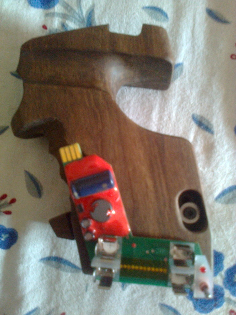

I got my rink 162ei grip for my titanium morini, the only problem is that the electronics or the battery block wont fit inside the grip. The grip fits my hand real nicely. I got a 85 mm grip.

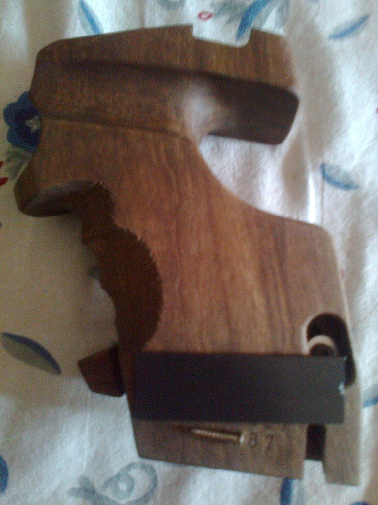

I ordered a 162ei grip with two micro batteries (AAA). I am uploading some photos of rink & morini grips. The battery cover of rink is made of cheap plastic.

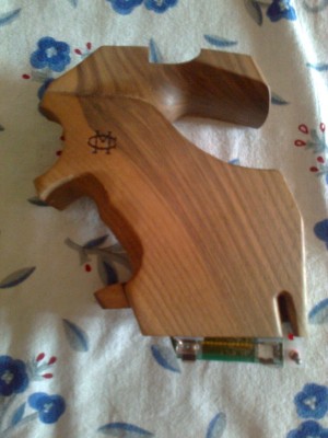

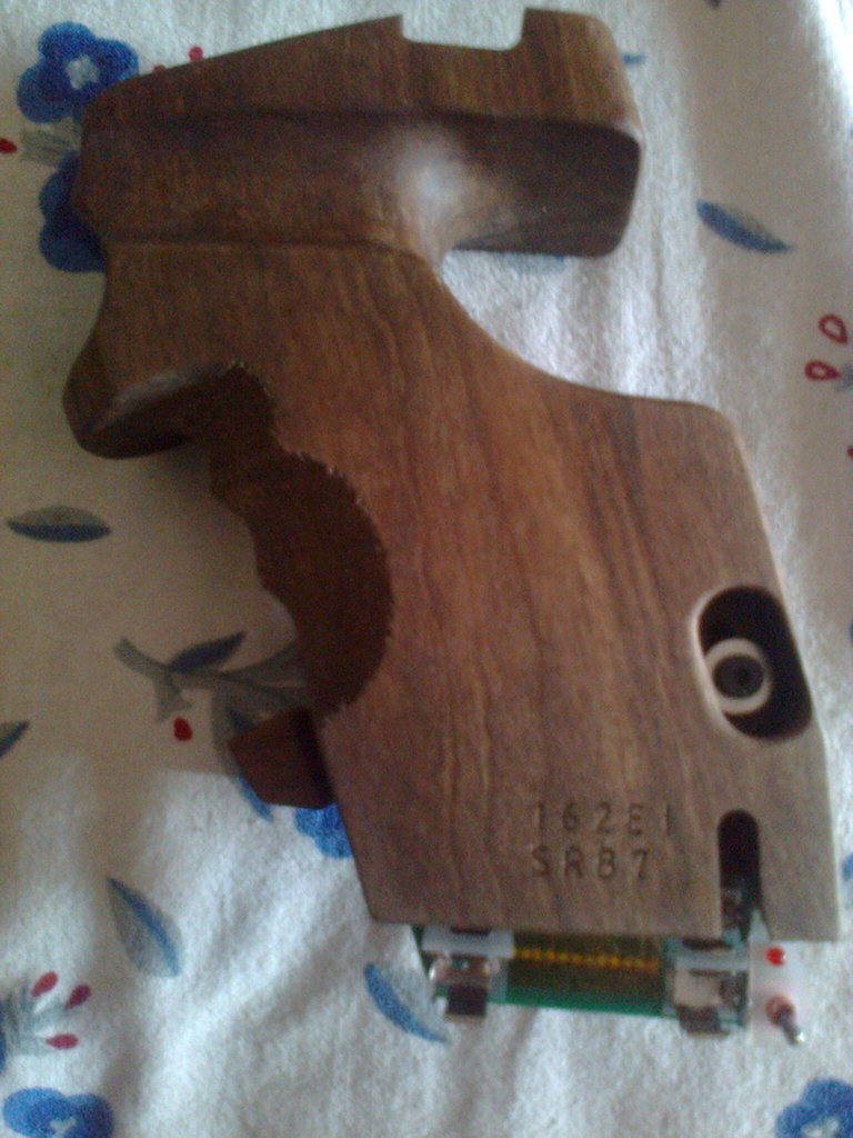

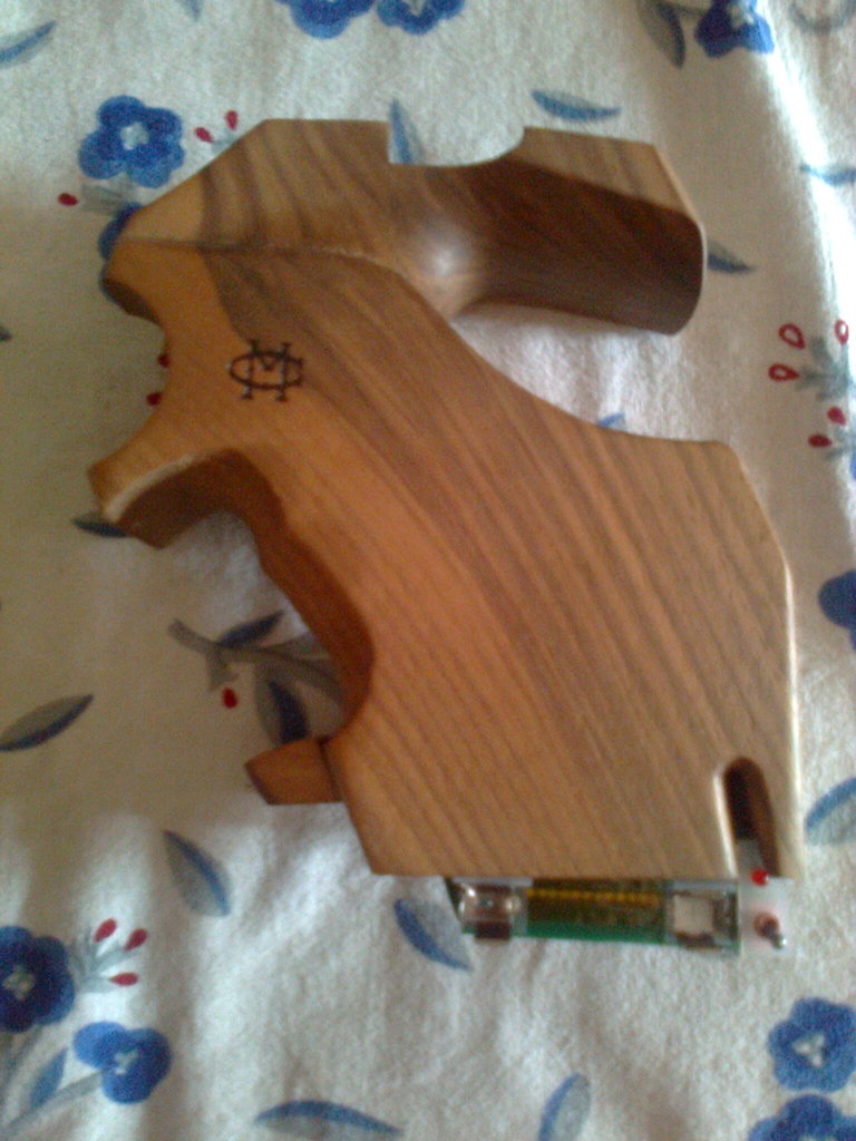

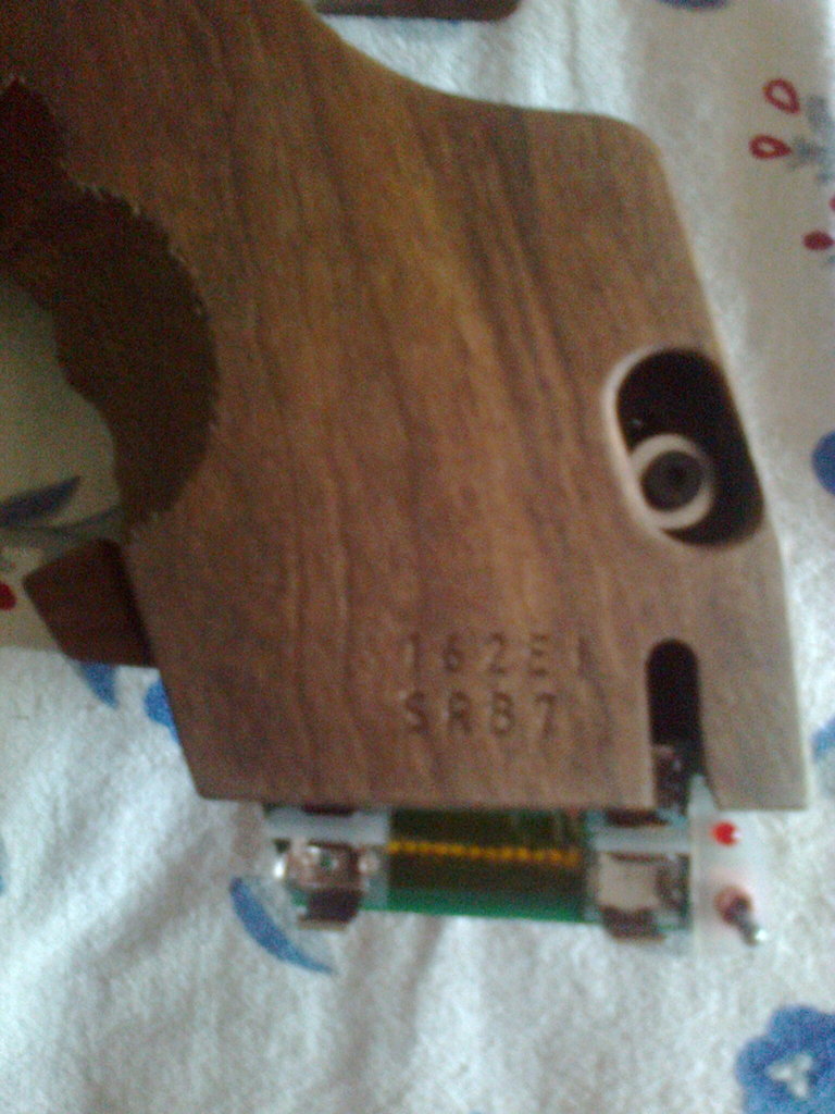

Check out these images as well
Battery cover
Battery cover

I'm going to say from those images you have a problem that Rink needs to deal with for you. In the image with the electronics overlayed on the grip it looks like it's not big enough to contain the elecronic board at all.
Send the pictures to Rink and tell them what's up. They should pay for your return shipping to them. It looks like the on/off switch slot needs to be at an angle at the very least.
You have the latest and greatest 162EI electronics board and you ordered the correct grip based upon how they labeled it 162EI. More or less I'd say they screwed up.

Hi I dont know if you got your Rink grip to fit your air pistol,
But i would like to set the Record Straight, i have also just received my Rink grip for my Morini 162 ei and i thought i had the same problem as you had,
I tryed to fit the electonics in, and it looked like they would not fit .The exact same as the photo,s you posted and was about to email Thomas Rink .
But then i pushed the electrics from the front end nearest the trigger guard and they popped in very snugly, so it is all about the angle how you try and insert the electrics , if you try and just push the electronics in the hole they look like they are too big and and the led light is 1cm from the slot hole so they wont go in. so for anyone buying a Rink Grip for their Morini 162ei rest assured they do fit and ther are no problems with Rink Grips .
cheers Steve
jbshooter
Posts: 364
Post by jbshooter »
I had a similar problem but overcome it by inserting the elctronics before fully tightening the grip screws to the frame. Leaving the screws slightly loose allows the grip to wobble and accomodate any bumps or mislignment as the board finds its way to its socket. I have purchased about fifteen Rink grips for air, standard, and free pistols. In my experience the quality of the grips, their fitment, and Rink's response to special requests has always been excellent.
