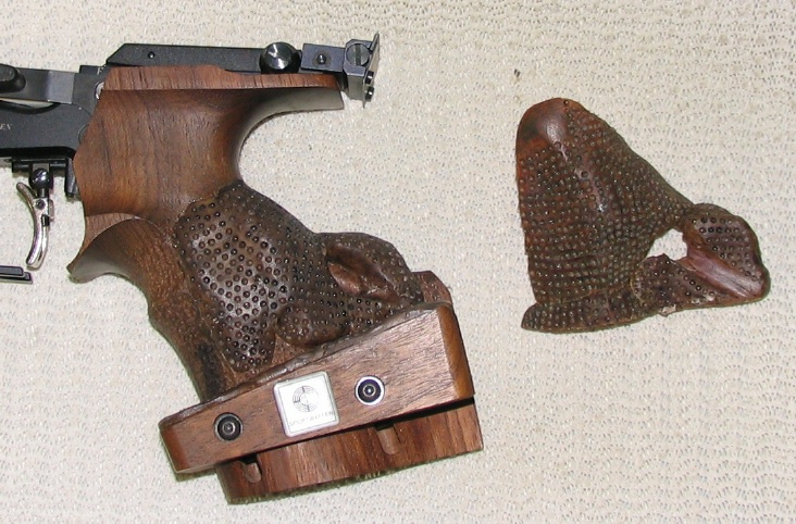

Had some of the same issues you are having. I was able to adjust the 2 screws on the back of the receiver so the sights lined up, but then the cocking lever would hit the grip because the angle was too much. In addition, I had a cant that I could not adjust out using the 4 bottom adjustment screws. (Probably due to 6 breaks in my wrist).
And, like you the grip did not fill my hand. So I used sculpy on my grip to fill in the empty areas and to enlarge the width. The nice thing about it, is it can be removed anytime you want, and reinstalled, without affecting the wood. Or you can just do another if you like.
The really great thing that happened when I used the sculpy to get a better grip, was that the other issues of cant and sight angle pretty much disappeared. Just needed minimum adjustment to make things right. The image shows 2 pieces I did for my LP10E.
If interested, let me know, and I will go over all the details and what I learned in the process.
Randy
