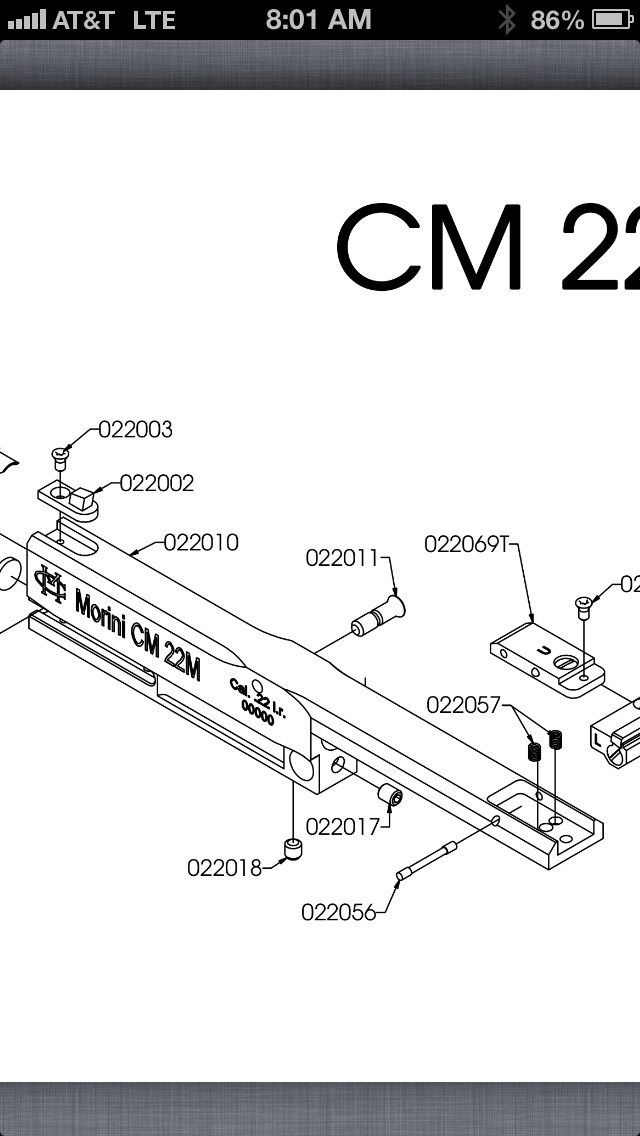

I need an advice on how to remove the screw 022010 on my Morini CM 22M as it is very tight. I wanted to install a rail for a red dot on it. I've used the supplied tool and one other that I have. I've asked a couple of shooters to help but it wouldn't budge. I worry that I may damage this brand new pistol. Thank you. LG

(did you mean 022011?)
If I remember correctly, this is just a Torx screw. I was able to unscrew mine easily. Try this - freeze the barrel overnight in a freezer and then heat it in the oven.

Yes, it's 022011. Did you see any sign of loctite? Are there any rubber or plastic that might melt in the heating process? Thanks.
javaduke
Posts: 105
Joined: Fri May 04, 2012 6:18 am
Post by javaduke »
No, as far as I remember, there was no loctite on mine. As for rubber or plastic, I'm not 100% sure, strip your barrel completely before doing it. You will need to remove the rear sight anyway to install the rail. Make sure you remove the recoil spring too.
