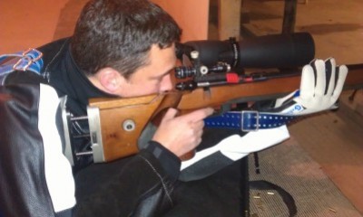

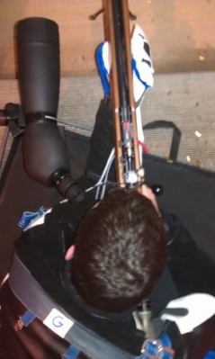

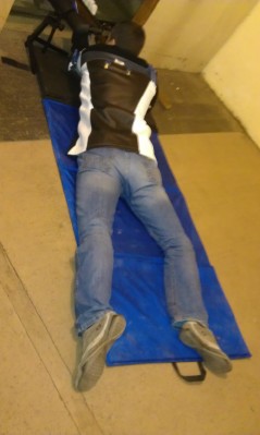

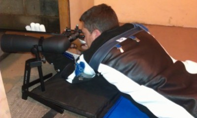

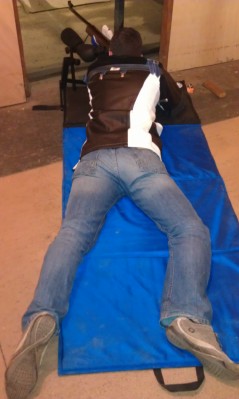

I have been having a bit of a problem with my position since I have changed to a new rifle (1813). I just can't seem to get comfortable and more importantly can't seem to find a stable position. When I relax my left arm bicep (sling arm) the rifle goes to the left feels like I am rolling to the left.
I have uploaded some photos, if anyone can spot anything wrong please let me know.
My shooting is getting worse which is very frustrating.
For reference the shooting mat is at 15deg's to the range.
Thank you in advance for any feedback and help.
Henry

It's hard to tell from photos, but it looks to me like you need to lengthen the sling a couple notches, extend the handstop about an inch, and move your left elbow about 1" or little more to the left.
Posts: 2102
Your left elbow is too close to the rifle. Ideally your left arm should be straight; i.e hand, elbow, and shoulder are in the same plane. This way the weight of the rifle bears stright down, against the sling.
If the elbow is out of line, the weight of the rifle makes the arm tip over.

Dunno wether its correct, but I always learnt to put the hand the other way around the belt.
Besides that, yr general position looks good, back, shoulders, legs..
How do you build up yr stance? There are 'tricks 'for grosse correct elbow position. Yr left elbow dóes look quite straight up.
Hows yr triggerhand doing by the way? Triggerfinger doesnt seem to be well in line with trigger

This is purely additional and secondary to the replies from more experienced shooters than I, but I just wonder what your previous cheek piece was like? I find the 1813 cheek piece too bulbous, so that it does not fit under my cheek bone and my whole cheek tends to slide off it i.e. to the left, as you apparently are doing. Depends on one's physiognomy, of course.

I'd second Pat's suggestion of slightly lengthening the sling and moving the handstop forward - together with a small shortening of the butt.
It could well be that you are tall with long arms - but reducing the pressure of the butt in the shoulder might allow the rifle to roll slightly more to the right and balance better.

KennyB wrote:I'd second Pat's suggestion of slightly lengthening the sling and moving the handstop forward - together with a small shortening of the butt.
You may want to consider some sight risers, too, as your head seems to be tilting down and to the right. I really dislike that style cheekpiece and found a piece of moleskin or the black Anschutz cover essential for maintaining a consistent head position.

Before the photos were taken I did lengthen the sling by 2 holes. It did feel a little more stable but I didn't go more because I thought I was then getting too low. I see what you mean by my elbow not being in line I will work on that.
The cheek piece is not the standard 1813 item the previous owner has made a new one with a dish cut into it. I guess this was to help over come the problems mentioned above.

What I personally would do is slide the butt plate a bit to the right there by taking the rifle closer to you eliminating the need to lean over the rifle. Another thing I would do, and this is just my personal opinion, is lengthen the length of pull a couple of centimeters because to me it seems that your right shoulder has to scrunch to meet the butt plate which will lead to muscle twitches. I also concur on the lengthening of your sling, I switched from a higher prone to a lower prone and saw my scores jump from 92s and 93s to 99s and 98s. I still have yet to reach that illusive 100 though. ;)

Others have suggested lengthening the stock (length of pull). I noticed your right wrist is bent. That could suggest the stock is too short. You should be able to draw a straight line from your trigger finger to your elbow with no bend at the wrist. I'm certainly not a pro, but that is my observation for what it is worth......
