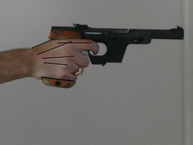

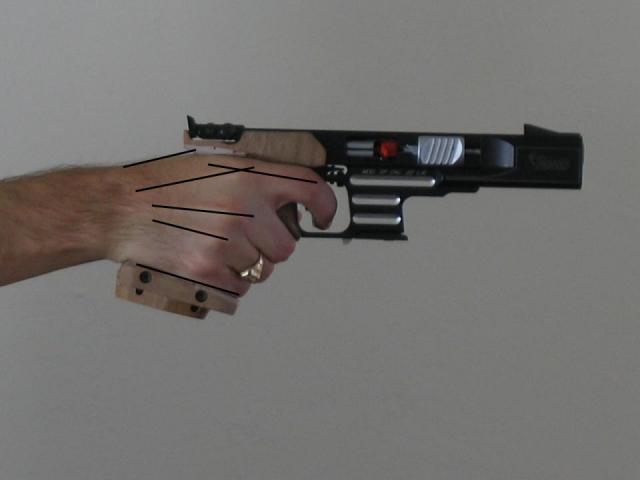

There's quite a bit of variation in what people consider a good grip angle. Here's a post I did on sport pistol grips:
http://www.targettalk.org/viewtopic.php?t=19764
The Pardini SP New factory grip is tilted about 10 degrees more than the Rink grip I got to replace it.
I can't shoot a severely tilted grip without elbow pain, and getting the Rink helped a lot. I actually shimmed it so it's a few degrees closer to vertical.
Part of the theory is that the angle helps to lock up the joints in the wrist, but I think many vendors carry this idea way too far.

when using a more tilted grip, you can let the pistol "hang" onto your ligaments that keep your wrist together. You need less/no musclework. Muscles can get tired, can twitch, can be moved (un)knowingly by you. Muscles are an active component. Your ligaments are a passive component and thus will less interfere in your shot sequence. Offcourse, as always: personal preferences, habbits and comfort and your physical (and the pistols) limitations have something to say aswell.
