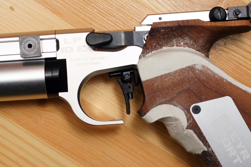

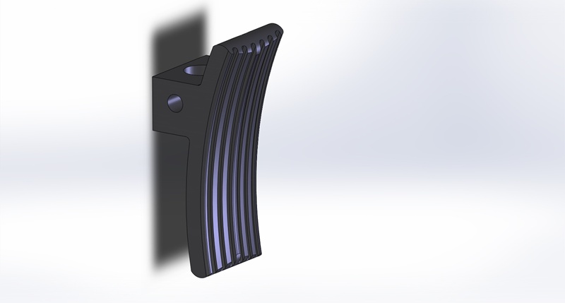

I was not quite happy with the shape of my LP10E trigger blade.
Was thinking about filing the original one or machining new one.
Then a friend told he had bought 3D printer.. :)

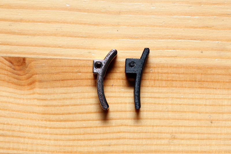

Steps: Make 3D model of the part -> Email him the model -> Print -> Finishing -> install.
LP10 trigger came out quite good. I was thinking about ordering a Stainless steel print from Shapeways.com but this plastic proto print may do just fine.
I´ll shoot a bit with it and see if more changes are needed.

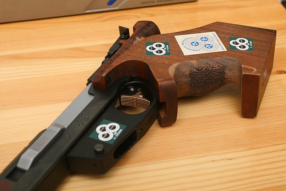

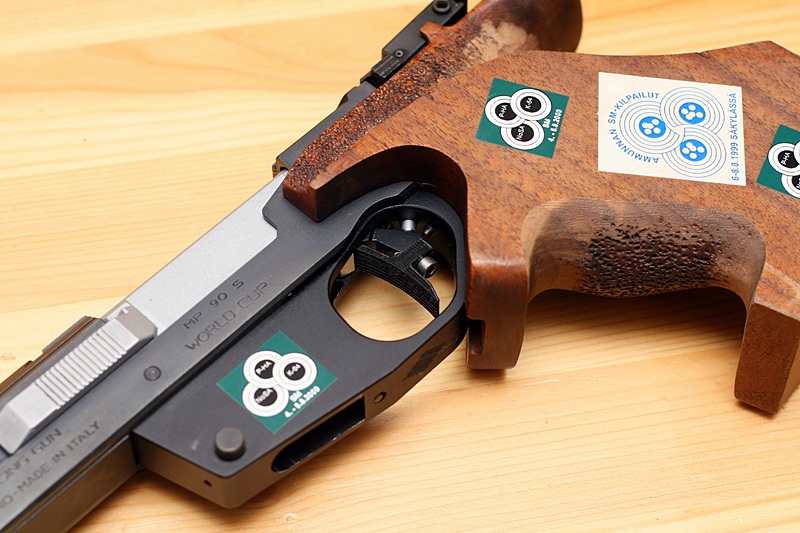

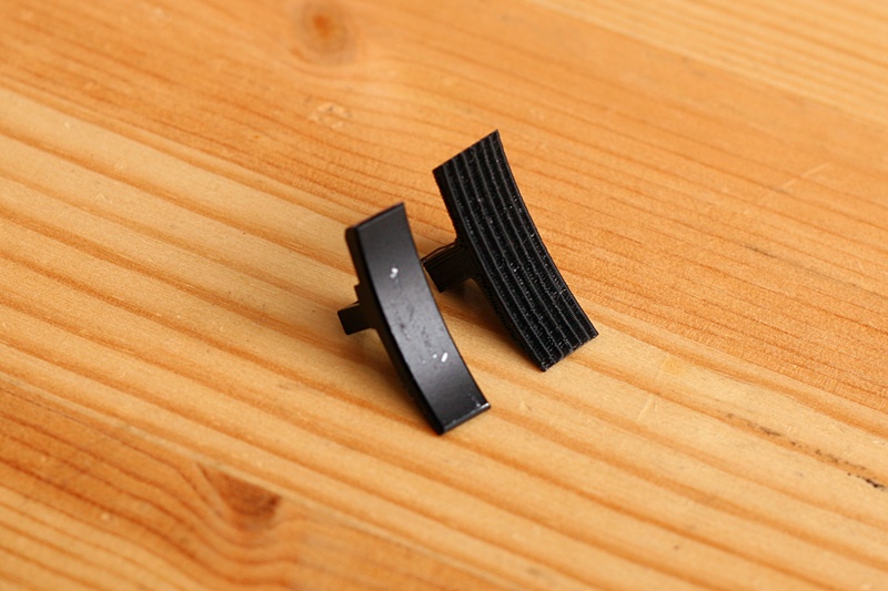

While at it, I made a new trigger for my Benelli MP90S too. Made it wider and less curved, added grooves. Shape is not quite right for my finger and plastic is too soft for the 1kg trigger of 25m pistol. Will have to redo.
Will I get more points doing this.. Probably not.

Looks great! How do you fasten the blade for the shaft? Using the same Allen screw? How do you actually perceive feel of the raised inner ribs at the blade, and do they help to position the trigger finger more consistently in the same spot.

Yes, I mount it using the same small screw that Steyr used to mount the stock trigger. Haven´t shot with the pistol yet, but thread tapped to that plastic doesn´t seem to be a problem.
As for the grooves.. the one rib in the middle is 0.2mm higher than others and ribbed front surface is curved in two directions. Don´t know if it´s any good but I´ll see starting tomorrow how it works. If not good, file/sand this one or make another one.
The stock trigger has a groove for measuring trigger weight.. That is easy to add to any 3D printing.

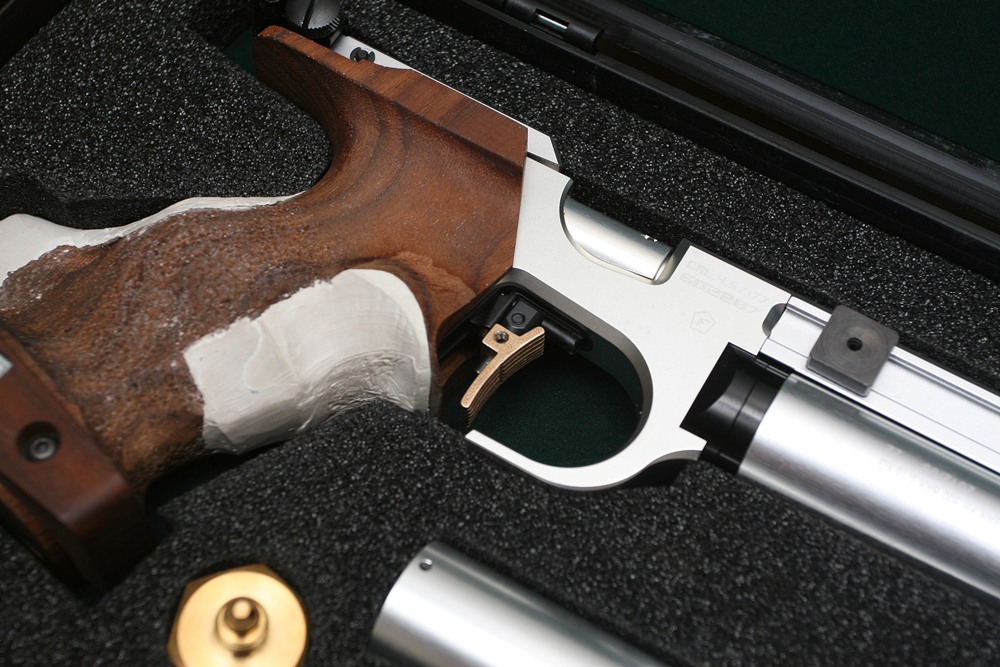

I made some changes to the shape of my trigger models and sent them to Shapeways. Since plastic was too soft for 1kg trigger of standard pistol and center fire pistol, I ordered parts to be made out of "Stainless" material.
Bit more expensive but.. Not bad. Even added the groove for trigger pull inspection weight.

That stainless process is not accurate enough to print M3 size thread.
I left both holes 0.2mm under sized and drilled them + tapped.
It may be possible to modify the model a bit so drilling is not required.
Shapeways says stainless Steyr trigger cost is $25,53 and stainless Benelli trigger is $22,02
Not sure what their base currency is so those prices may vary a bit.
Steyr 500g trigger pull and the mounting method of the trigger blade allow use of cheaper materials. My friend made prototypes out of some black plastic. Worked just fine.
My Benellis are adjusted to over 1kg trigger pull so stronger material is recommended. Stainless works. Don´t know about other materials Shapeways offers.

Posts: 1231
Just ordered one for my Steyr.

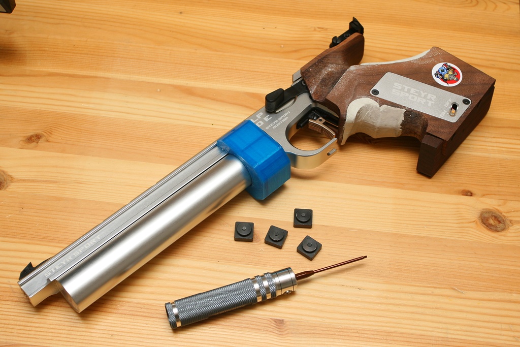

This is not a trigger blade, but still a 3D printed part for a pistol.
We started talking about how much different pistols weight.
So I measured mine.
I had a Morini CM162e before I bought this Steyr. It was the first model with fixed tank and I had made additional weights for it years ago. Total weight was ~1180g.
MC55-1 -> 1150g
Benelli MP90S world cup (empty magazine) -> 1150g
Steyr FP -> 1290g
Steyr LP10e with those four weights that came with it -> 980g.
(Scale I used was not the most accurate, but gives some idea..)
hmm. What if I add weight to Steyr so the pistols I mostly shoot (Benelli, MC55 and Steyr) weight the same. So. Some measuring, modeling and emailing.
"Lead tank" is divided in five sections that can be filled with lead. I don´t yet know how much it can weight but we´ll see.
edit: total weight with 2,5..3mm shots, sections full -> 125g.
Now does this give me more points.. propably not. But I like to build things.
