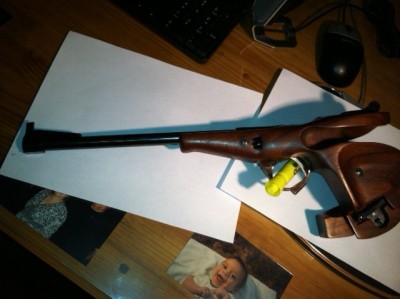

Hello all, I am a novice Free Pistol shooter and I am "test driving" a IZH-1 pistol. The pistol is in great shape and appears to have been shot very little. I have run approx 100 shots thru it but it seems to want to "miss-fire" about every 5th shot. I load it as normal push up on the lever above the trigger , apply pressure to the trigger and then, nothing. I eject the round and try again, sometimes it will work and sometimes it will suddenly go off with no pressure on the trigger. If anybody has suggestions or info on this pistol I would be most thankful.

It looks interesting. I have no experience with the model. However, from your description of the problems, I'm wondering if the firing pin might be captive but broken?

I don't have an IZH -1, and I would think few people do. It looks like it has a Martini-style falling block action from the pictures here:
http://toz35.blogspot.com/2011/11/izh-1 ... istol.html
From your description, it sounds like the sear is not engaging properly. If it is like the TOZ 35 mechanism, the cocking lever opens the breech and engages the sear with the striker. You would feel a resistance to opening the breech that would let off when the breech is all the way open. If the sear is not engaging properly either because of wear or bad adjustment then the striker might not be retained when the breech is closed. The trigger will still set and "click" when you press it, but the gun will not fire. Also, if the sear engagement is faulty, the striker may sometimes be just barely detained by the sear and drop spontaneously.
Ask the owner if he knows how to adjust the sear engagement and see if that helps. If there is no adjustment then it will may have to go to a gunsmith.

Very interesting grip. Usually this pistol has a totally enclosing grip, with grip and fore-end form a one big unit. You cannot even see your own hand!
